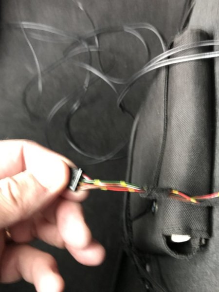

Whilst looking to thread it back I have noticed another wire and connector that has come down from the left hand side of the console which I’m hoping someone can identify please.
Whilst I’m asking favours, I also have another mystery wire dangling from the driver’s side of the console too. Help with this one would also be appreciated please!
Looks like another aerial type connection to me.
Thanks in anticipation!

The black connector is for the clock as I guess yours has a OBC
The aerial type looks as if it is a DIN audio connector for a auxiliary input to the stereo.
