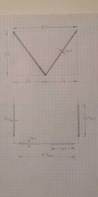

I've got a 12 ton press, but I don't think that would touch it. The beam was twisted rather than bent. I cut the beam and I did consider welding it back together, but this time straight. I abandoned that thought after about 10 seconds.
I've decided to "do a Randy" and just throw metal at it =)) .
I have done some man-maths and have worked out that I can replicate the resultant force using the two perpendicular vector forces if I weld metal to the three sides of the lower section. See below. I'll be using 3mm steel instead of the 2mm that they used.
The lower section will be one piece of steel, not two. The illustration just shows what I think is needed to replicate the two 2mm pieces, but using 3mm steel.
I've made a start and have welded the lower section to the beam, and it looks like it can be done.
I'll also be adding camber and toes adjustment plates to the rear arm supports.
The dimensions are the same for both beams as far as I can tell. The only external difference is that the M-beam has an exhaust bracket on both sides. The standard beam only has the bracket on the left side.

Standard beam has no internal reinforcement that I can see. The reinforcement on the M-beam is visible through the drain hole, but I also had a look using a boroscope to see where to cut the beam.
The standard beam is used on all models of E30 and E36, except the Ms.
The E30 M3 has a unique rear beam. I suspect that it has reinfocement, but only one exhaust bracket.

Yes, everything looks the same - and I've had my M arms bolted to the beam, so it all fits together.
It's probably not necessary to beef up the beam, but I thought I'd better - just incase I get the urge to give it the beans :racecar:

Honestly, I don't think it is necessary to strengthen the beam. The additional strengthening inside is so marginal that it probably only adds a few percent to the strength.
I don't think it was a case of the M would break / distort a standard beam. I think the factor of safety was probably below the accepted level. and BMW were just covering their asses.
