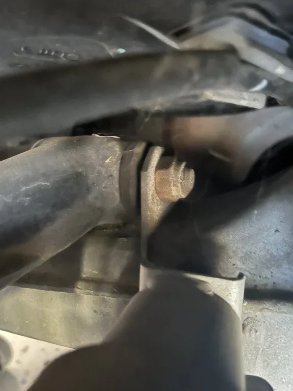

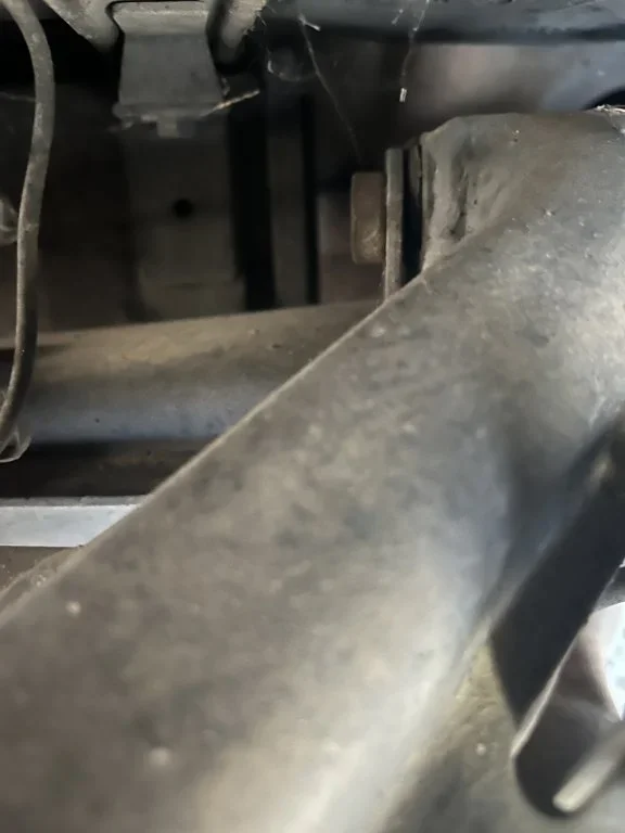

Hi guys. I picked up the car today. I’ve lost confidence in that shop. Here are some pics.

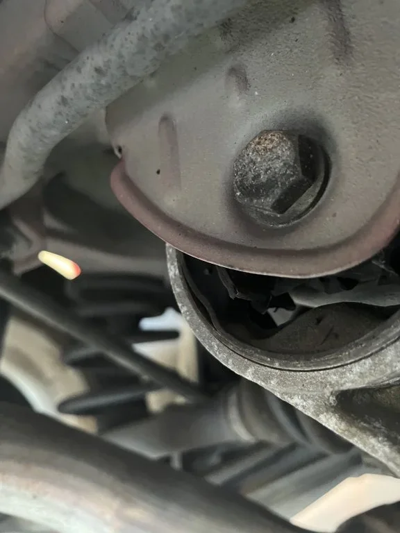

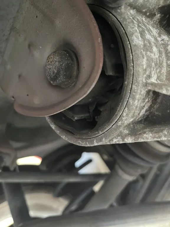

The first 2 are Rear Subframe Bushing. Rubber isn’t dry but definitely touching the lower plate.

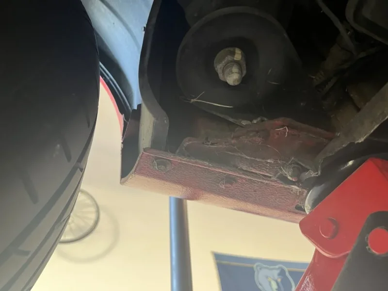

The second 2 are the Rear Trailing Arm.
I next 2 are pics of where my diff bushing used to live.

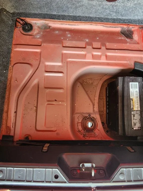

The last one is my trunk bottom.
I’m going to get them put on at another shop. Also looking at shocks. What can I expect to pay in labor?

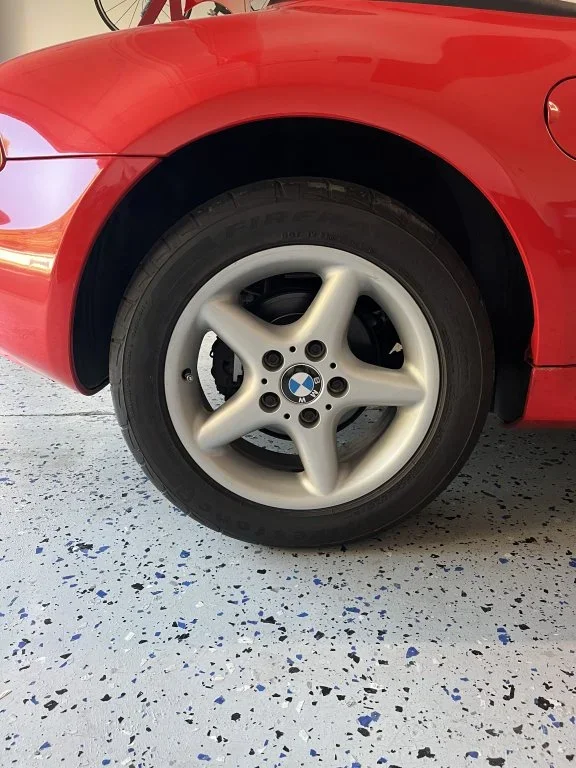

Looks brand new under there compared to my wife’s,is it driven in the rain? 😂 The lack of rust/ corrosion will certainly help your rebuild. Most of us in the UK have a fight with rusty fasteners which makes replacement of anything under the car take longer than it should.

It looks very clean.
If it drives well and doesn't clonk/knock over bumps, save your $$$.
Bilstein B4's are budget dampers - they're OK but not as good as OEM Boge Sachs which you already have.
