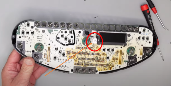

the problem is with the digital display, please see photo.
I saw some youtubes videos that talk about the need to remold the legs of the display unit.. but I don’t know if to try it or just replace it.
As you can see in the photo – the first line lights very very low
The second – have nothing on display
And for the third – I don’t know what it supposed to be, but its look wrong.

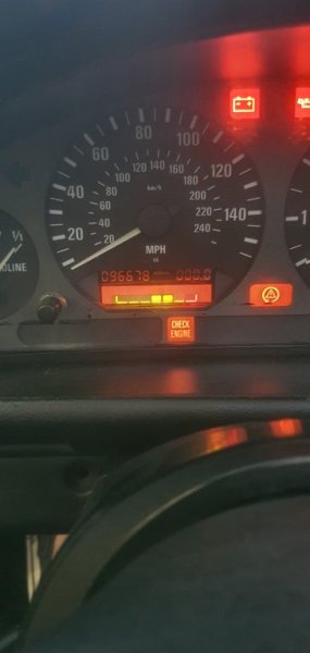

Ok, it’s not as bad as you think.
The bottom row is showing when the car needs a service. As each block switches off, it gets closer to the need for an engine service. If you have the manual, have a read and it’ll explain it better there.
The display being dimmer can be repaired by sending it to an electronics specialist. In the UK I’d recommend using Autotronics, but you may have another specialit where you are. Check out goggle. It looks as if it is simply dimmer, so not a catastrophic fault.
ill get a picture of mine and post it in a few minutes

This isn’t mine, but it shows what I mean.

Looks like the backlighting of your odometer and trip meter has failed. Not sure how it works, but I would suggest that your more important problem is why your check engine and traction control warning lights are on.
Picture shows what can be displayed, from the handbook.
Take the binnacle out and replace the back-light illumination bulbs (there are 5 IIRC, 3w 601 style bulbs which are removable fron their holders.

If the digital mileometer and odometer are dull it will probably be the bulb behind them. I had this and it was a fairly simple fix. Before and after

Zed models are different so you may find yours is not exactly as the photo you posted and you'll only find that out once you've removed the binnacle (a rubber suction cap is useful to pull it out after you've removed the screws). The Odometer and Service lamps are likely to be 12v 1.5w have a fixed beige base. If so, Osram 2452 mfx6 bulbs or equivalent should do you - Autodoc sell for approx. £2 each.
While you've got the binnacle out it's likely worth changing the dash backlight bulbs as well - there are three of those and are wedge type that fit into removable green bases. These are 12v 3w W3W and Osram 2821 bulbs or similar should be okay - Autodoc sell for approx. £1 each.
If any of the telltale warning light bulbs have gone, then Osram 2351 mfx6 will do. These are 12v 1,2w and have a fixed black base. Approx £1.50 each from Autodoc.
Just be cautious about buying anything until you've had a look first though.
I'm hoping I'm right on this, because I'm planning on doing the same myself later this year. I'm sure someone who's already done it will be along to correct me if I'm wrong. Good luck!
