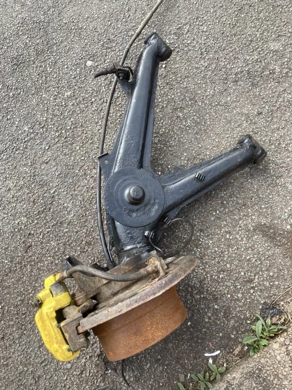

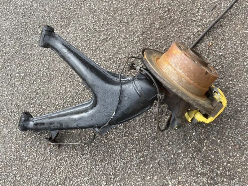

I’d go and see Andy with a van 😁. If one arm has gone then the other one won’t be far behind. I also think your friends 2.2 is a Sport ..finding Sport springs can be difficult.
Andyboy
Jun 2, 2019
119
SHEFFIELD
I've got trailing arms both very good used and refurbished.

Aah.
These are for a 1.9 so no good.
You might be better off getting your existing ones properly repaired.
