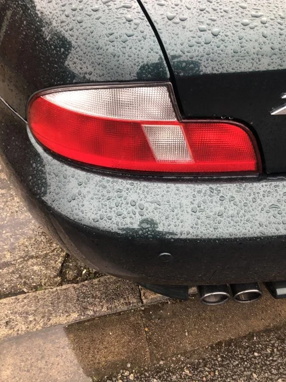

Well I had been quietly confident that my Z3 would pass its MOT today but yet again the tester has picked up something unexpected. He did show me the fault and I suppose I have to admit he is right.
The fault is the reflector in the rear near side light cluster does not reflect when shining a torch at it, of course I have never noticed this, the light unit is undamaged and the car hasn’t been used in the rain since the last MOT, it wasn’t noticed then.

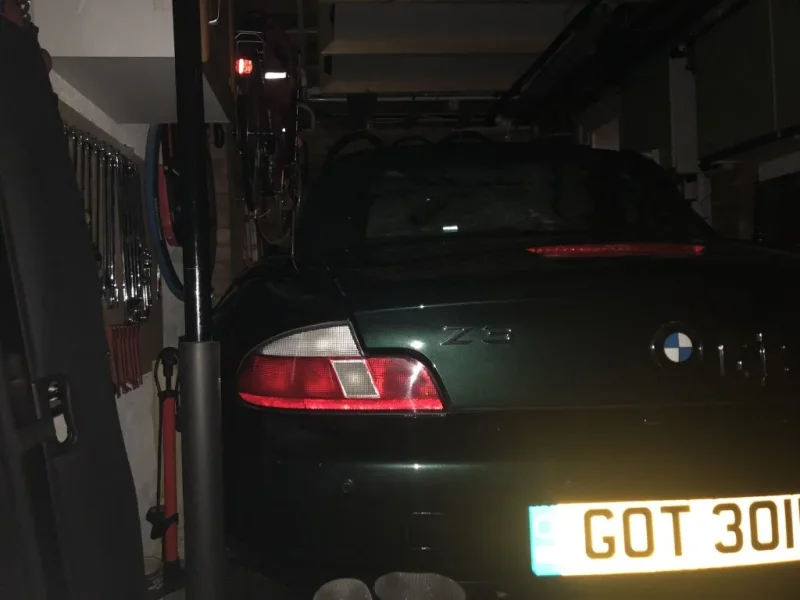

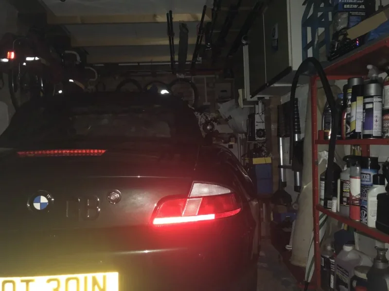

If possible could you take a picture like this to compare ( preferably at night) take picture directly behind the light at same level about 3 / 4 feet back with flash on .
Just took this and as you can see the number plate and the straight on part of the reflector lit up ( the angle bit only just catching the light as not straight on.
I would like to see the comparison
Stephen.
Just to put an end to speculation about over zealous MOT testers On the advice of Stevo7682 I took two photos with a flash and they clearly show a defective reflector on the nearside. Thanks for your interest in my problem.

Well I wanted to investigate why the reflector didn’t work and I think I found the cause.
The previous owner of my car has tried to fit reversing sensors and brought the wiring through the foam rubber seal, this has allowed the chrome reflector of the unit to get tarnished. I tried to dissemble the unit but it was well and truly glued and I managed to completely break the lens, I really do need another unit now. I cleaned the reflector and placed it back together to see if it worked and it did. Only fit for the bin now.
