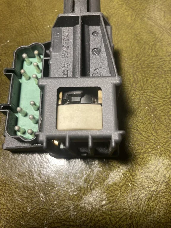

In the past I already bypassed the headlight rheostat. In the last 2 days (when lights are on) the dash and interior lighting go on an off presumably due to a bad contract. If I play with the knob (no jokes now....) I can get the dash and interior light to flicker.
Can anyone save me some playing around?

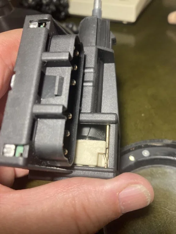

Ok - I opened it up and the plastic housing encasing the “plunger” was cracked. I’ll try contact spray as I look for a new one.
I assume the RHD and LHD electrics are identical… (obviously the air inlet is the mirror image)
PS - until the new one arrived 8 weeks later - I epoxied over the cracked and it worked fine.

This was one of the first jobs I did. I took the chance and bought a second hand switch from eBay - £50.
There are a couple decent videos on you tube about how to remove and replace - I followed those: it was straight forward to do, took about 40 mins becuase I was taking my time and it worked perfectly.
My dash lighting was temperamental with the original switch. On taking it out, there was white powder everywhere - looks like the rheostat was physically degrading. Oxidation or vibration maybe.
