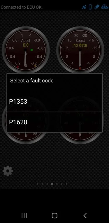

I've a 2002 2.2 sport . Its has this very annoying issue. When starting the engine from cold it develops lumpy idle when the engine lowers its revs down this will bring up the E.M.L . If I start it from cold and hold the throttle at around 1500 rpm until the temp gauge has started to move the light won't come on and it will idle perfectly fine on it's own then. Fault codes I have logged are P1353 and P1620. I've replaced the spark plugs with a new set of NGK and move coil pack #6 to #1 but still have misfire on #6 . Has anyone else had a similar issue? Thanks Stuart. Hopefully see some of you at Silverstone Classic.

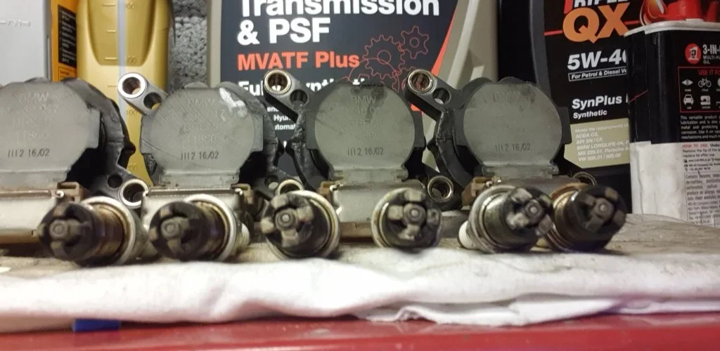

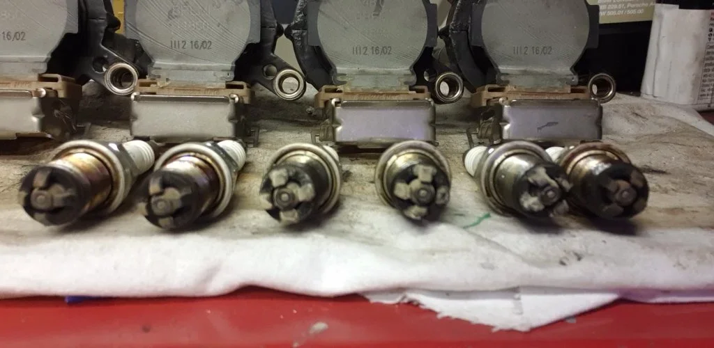

Thank you for your reply. Swapping the coil packs hasn't moved the fault to another cylinder. The injector over fuelling sounds interesting . Looking at the original plugs that I've now replaced #2 #3 and #4 look to be running very lean compared to #1 ,#5 and #6 . I might swap #1 and #6 injectors and see if the misfire then moves to #1 cylinder.
