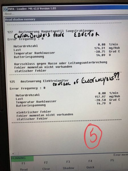

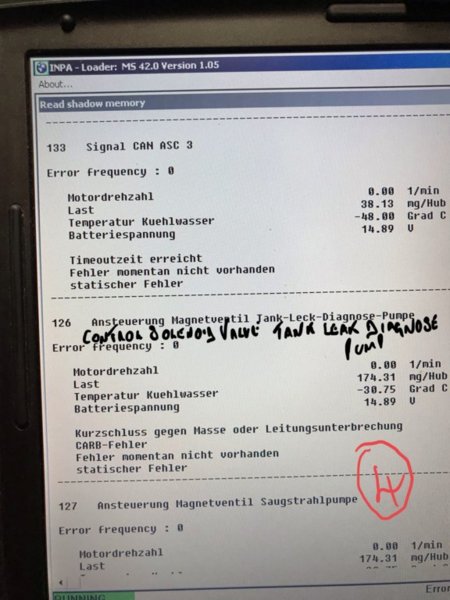

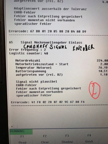

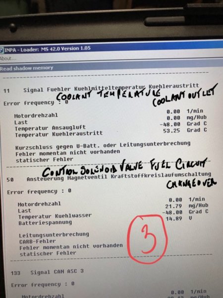

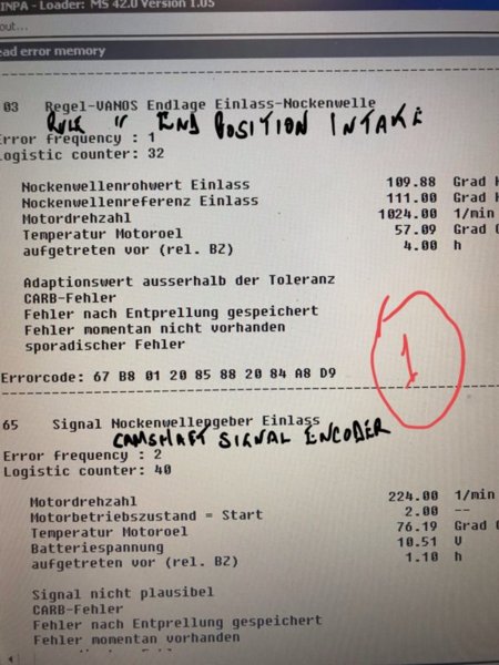

dva99999
Feb 14, 2016
85
Wirral
Unfortunately gone
I’ve reset them but after a few days some have reappeared. The problem I have now is that the old windows laptop I was using to read them has given up so trying other options is proving difficult!!
