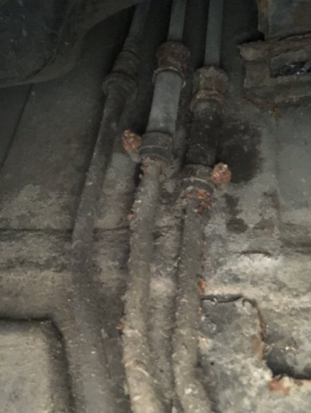

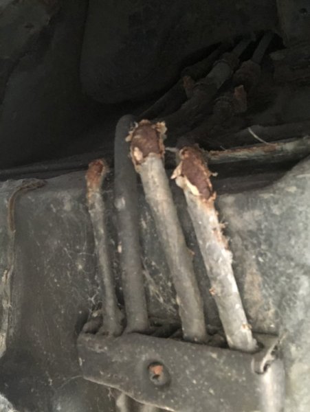

Metal fuel line?
They will be 8mm OD. Use copper to replace them, much easier to bend than steel. You can buy original from BMW but quite expensive.
You can check the size by removing the piece from inside the rubber connectors as this will be free of corrosion.
