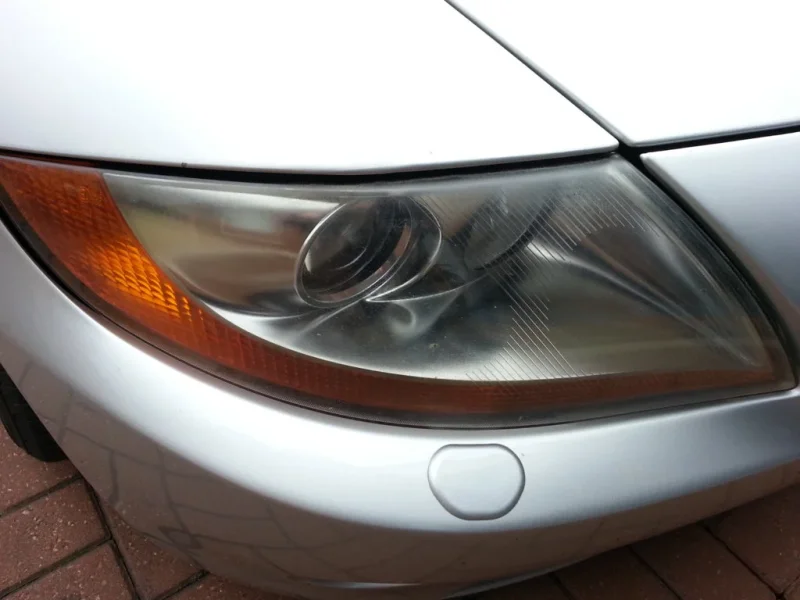

    I've broken this topic off from @BMBabe's Project Panther thread as it's really interesting in it's own right. Pictures pretty much say it all. We decided to take the headlights out as everything is easier on a bench!
    We used the Meguiars Headlight Restoration Kit which is about £20. There is easily enough supplied in the kit to do 2 possible three cars with it making it even better value.
    Before pictures of the headlights. You can see how bad they had got, and in desperate need of attention.
    The process involves wet sanding the lenses using water and supplied sanding pads. They are 2 inch square pads, with a different grade on either side. Sand with one, wipe clean then sand with the other side.

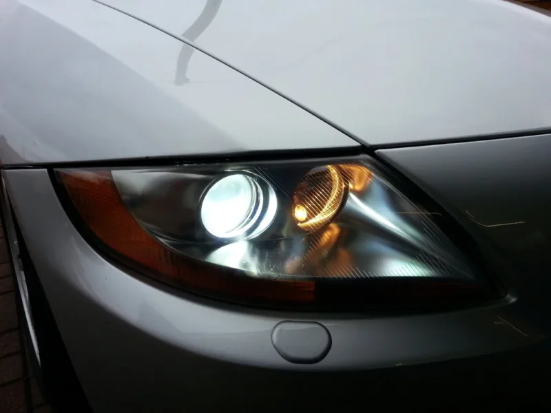

    Next the Meguiars Plast-RX is applied to the lenses and buffed with the supplied buffing pad in a cordless drill.
    The result after much buffing by @Lee ...

    To answer your question, The first headlight i did three times over so took me around 20mins. The second headlight i went heavier with the sandpaper so only went through the process once. You can easily do both headlights in 30mins-45mins.

    Did mine with t-cut .was a bit cloudy but looks better now .befor an after
