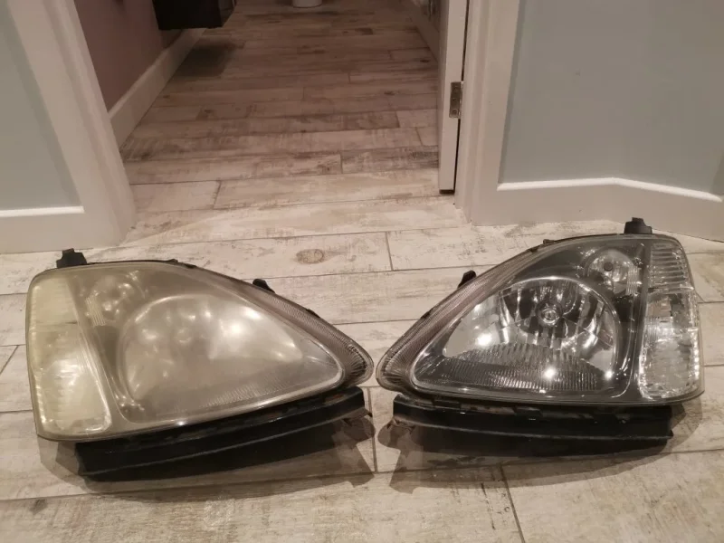

I use the autogylm kit. 23 quid, but enough sanding pads to easily do 2 sets of headlights, and at the end you can use the drill mop head that comes with it for buffing difficult to reach paint scratches. Done a set the other night on a Honda civic, can up quite good
