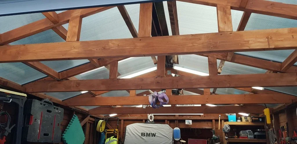

Hi gookah great write up. Having spent some time studying your photos am now suffering a severe case of garage envy (along with Steve Medlock & probably many others). What is the roof made of, it looks translucent?
Ian.
I fitted a new roof with bronze 10mm twin wall polycarbonate sheet.
from here:
https://www.varicoltd.com/polycarbonate10mmbronze.html
they were the big sheets, 2500mm x 2100mm.
does not form condensation or drip like the single wall stuff I had previously,
Lets light in, not as much as the clear version, but stays cooler.
from here:
Thanks for the info. Our Garage is prefab concreate with a tin roof. Condensation in winter is terrible. We are thinking about replacing it with a wooden one when funds allow. We hadn't thought of a translucent roof. It certainly looks good on yours, lots of light, so it's given us something to think about. Thanks again.
