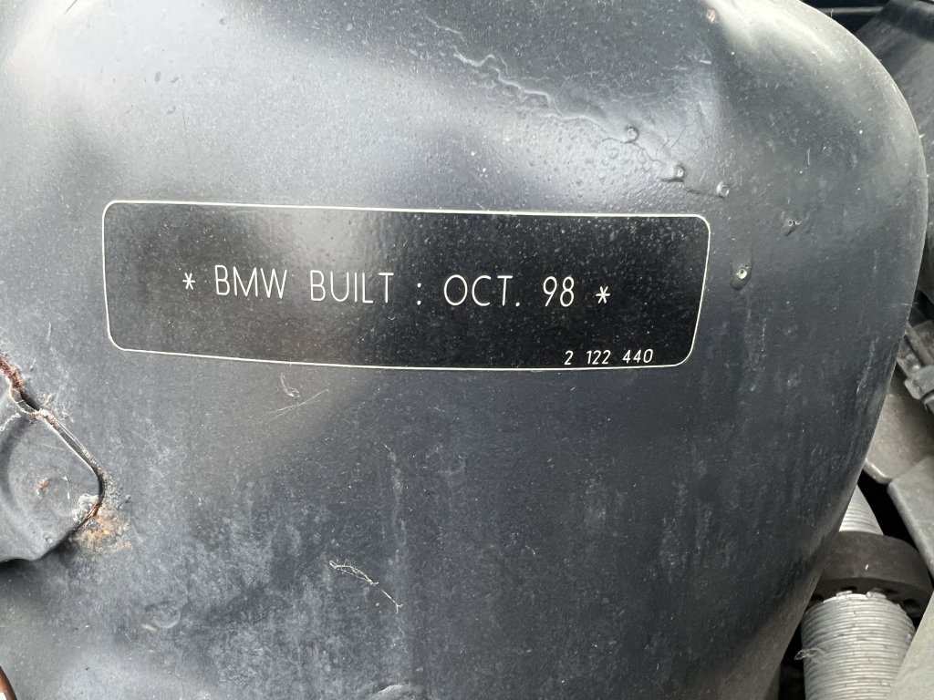

With Tom’s Zed very nearing the end of the build we took in the next Zed. This Zed is a very unique Individual Orinoco with the finest 2.8 engine . What makes this even more unique is the fact it’s a 1998 model and has the later M52TUB28 engine, the vin even confirms its correct from factory. She had a respray last year and now ready for a front to back refresh.

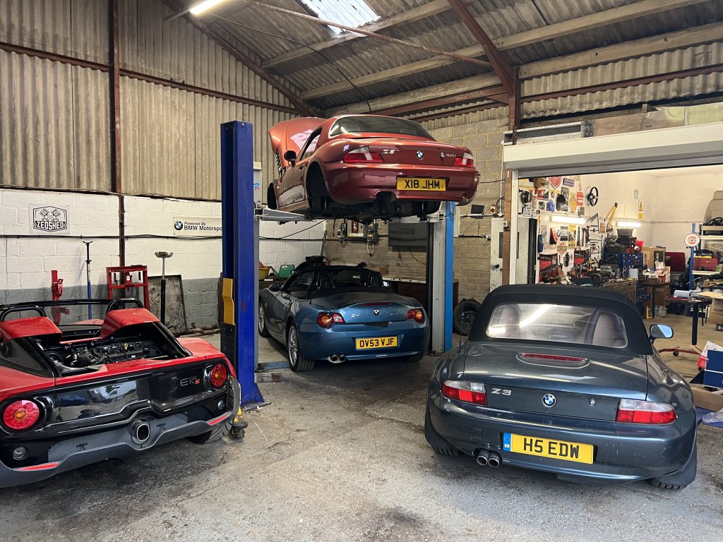

So today we decided to make a start and look at what’s ahead on Mary. She’s very crispy round the edges underneath nothing out of the ordinary for us.
Nice full under body shot showing the exhaust removed.

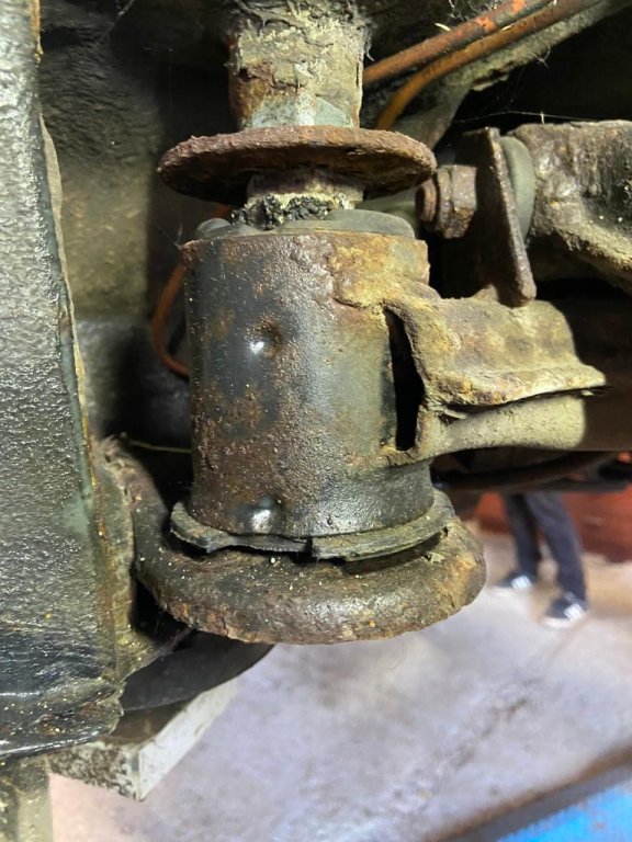

Confirmation of completely tired beam bushes. You can see the bush sat down on the plate when the gap should be big enough to fit a finger.

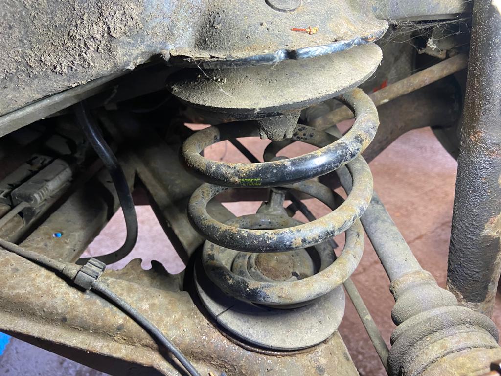

tops of arms and springs look ok.

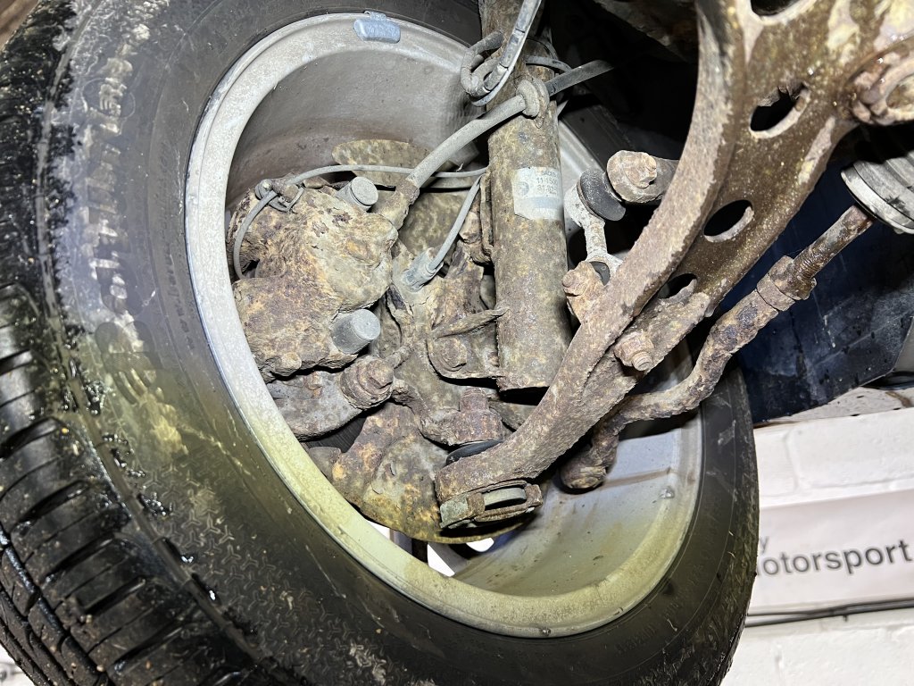

Front
crispy from the inside out.
