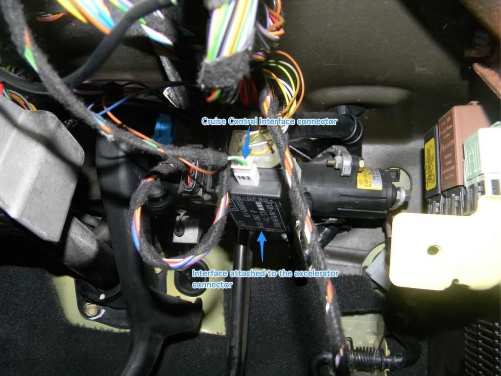

After reading various posts regarding the retrofit of cruise control to the various models of Zeds I decided to give cruise control a go on my car.
My car is a 2002 M54 3.0i build date nov 2001 with a fly by wire throttle. As far as I am aware this guide is applicable to all fly by wire throttle Zeds.

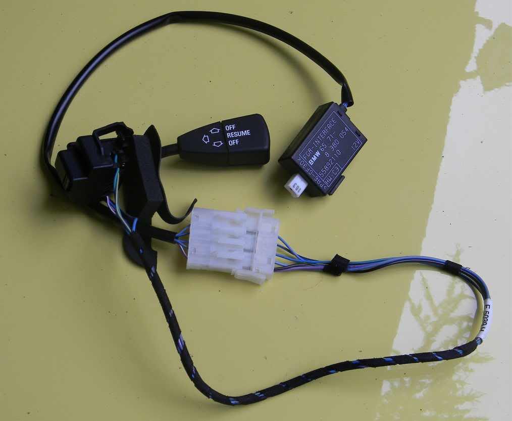

Parts Ordered
  • 1 x Interface 65.71.8.380.054 - £40.88
    1 x Switch 61.31.8.360.926 - £55.95
    1 x Knob 61.31.1.390.968 - £5.94
    Total £123.32inc VAT
The cruise control switch/knob & Interface ready for connection to the car

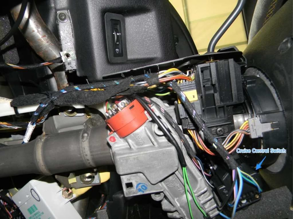

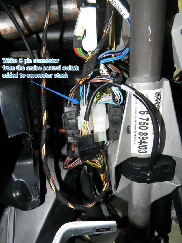

After removal of the bottom steering column cover the picture shows the the cruise control switch installed and cable routed. The switch just pushes in to a pre defined slot.
Connector in place
Interface Installed

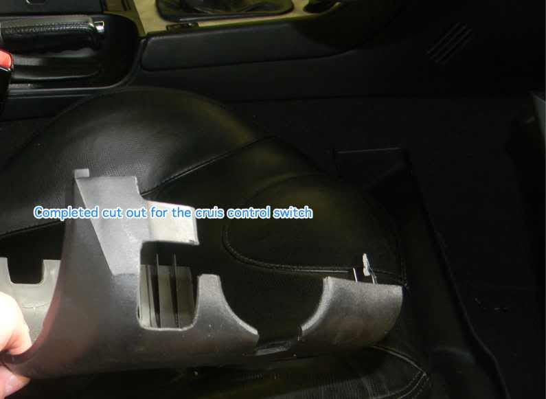

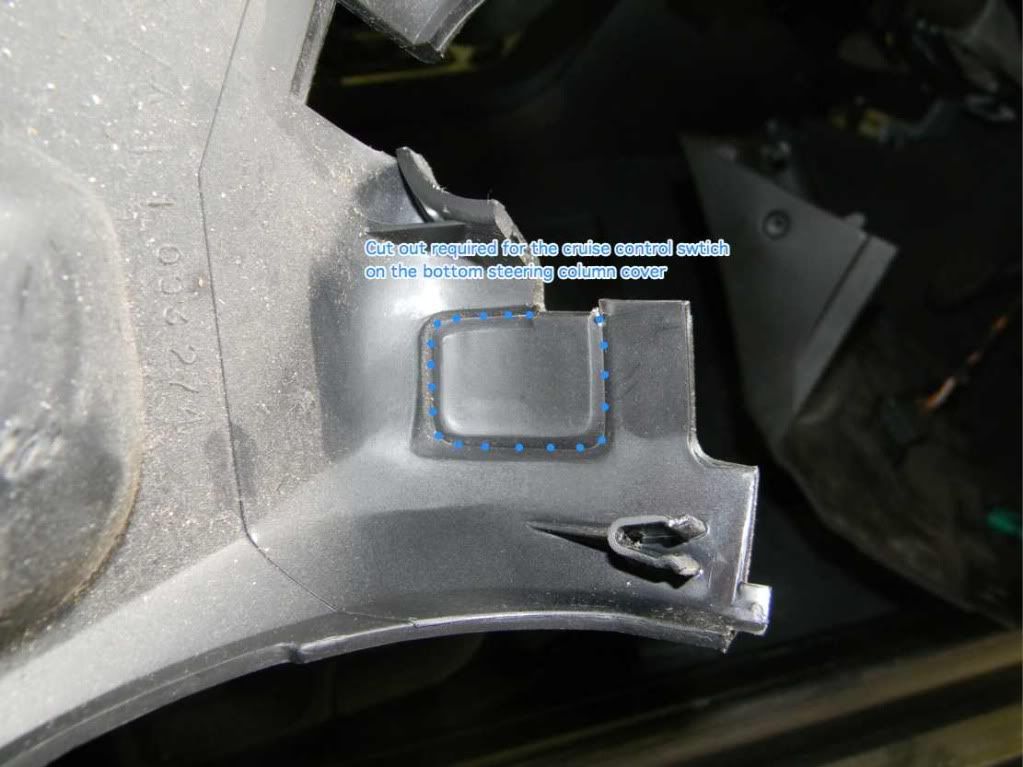

Hole section to be cut for the switch
Hole cut in bottom steering column cover
Switch Installed before covers are put back on
Fully Installed
The job took about 1hr to complete and all works as it should :D any question please ask.
I have PMed Brian with this but if anyone else has the answer I'd be grateful please. I have the interface and switch but cannot find the little three pin white flying socket that plugs on to the interface. I am assuming that it simple hangs around under the dash somewhere but I have looked everywhere it seems, and there's only one 'free' connector and that's black with more than three connections. Where should I look please? Thanks... 52 plate 2.2 Sport M54 engine
