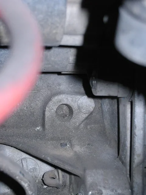

US market single Vanos engines used an iron block.
BMW replaced thousands of engines under warranty / goodwill. If you can see a rusty metal plate under the starter motor, you've had a new engine in the distant past.

This is the original Nikasil block:

Nikasil was discontinued before the Z3 entered production.
Andyboy
Jun 2, 2019
119
SHEFFIELD
Nikasil was discontinued in Week 10, 1998.

Mine is Jan 98 single M52B28 and just over 140k miles and doesn’t use any oil.
Don’t know if nikasil or not.
Thanks for those handy pics @Andyboy , curious now to see what it is!
