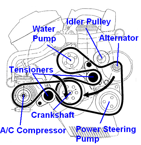

Thanks for response but not quite following what you mean Brian. The layout on the 4 pot is as per photo with a single tensioner. There is no noticeable play on actual pulley wheel but with engine running I can get a listening stick onto bearing and can hear an amplification of the distinctive noise.
@jonco sorry for any confusion I have only seen the 6 cyl and they have a fixed deflection/idler pulley in the system. Theer ar two belt as well the second drive the A/C and has it's own tensioner.
@jonco sorry for any confusion I have only seen the 6 cyl and they have a fixed deflection/idler pulley in the system. Theer ar two belt as well the second drive the A/C and has it's own tensioner.].
Ok - thanks understand your point now. I've never seen the 6 pot layout so didn't have a clue ( again - haha)
