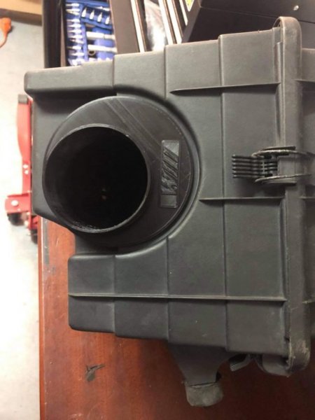

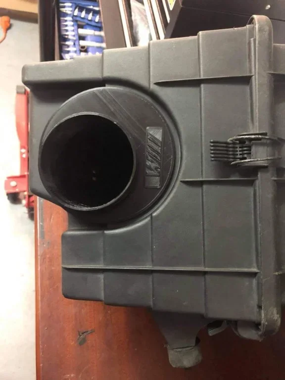

New Mod - cold air intake using the stock airbox.
3d printed a 76mm intake to replace the fog light:
and an adapter for the airbox:
DIfference on the airbox inlet size:
Then I have a flexible 76mm hose connecting the 2 parts.
The car seems the to be breathing better and the engine noise is more pronounced.
