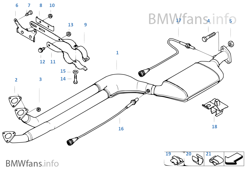

Tony, re the lambda sensor conversation the other day. The garage who serviced the Zed did an emissions test for me and he said although it failed with a run first he thought it would pass. He checked sensor 2 that "R" had flagged up on the computer and said there wasn't a sensor there after the cat? He didn't know if it had been removed or it had never had one. Strange would you think? o_O
The problem is Dave, there are cars which don't actually fall into either category, so if a car fails and the tester is unsure they should look in the " In service Emissions book" which VOSA supply where specific vehicle test data is listed. If you contact Sopers I'm sure they could tell you if Reggie has 1 or 2 sensors. Yours is a '98 ? 2.8?
If so, it only has one looking at this. Part No. 17 is not on the list for the car.
Catalytic converter/front silencer
BMW Z3 2.8 Z3 Roadster Europe M52
Right-hand drive, Transmission: Neutral, Production date: January 1998
16
Oxygen sensor
18
Lambda-probe bracket
21
Cable clamp
16
Oxygen sensor
18
21
Cable
Interesting to know thanks. Wonder why the computer picked up lambda sensor 2 faulty? Maybe because it hasn't got one?
