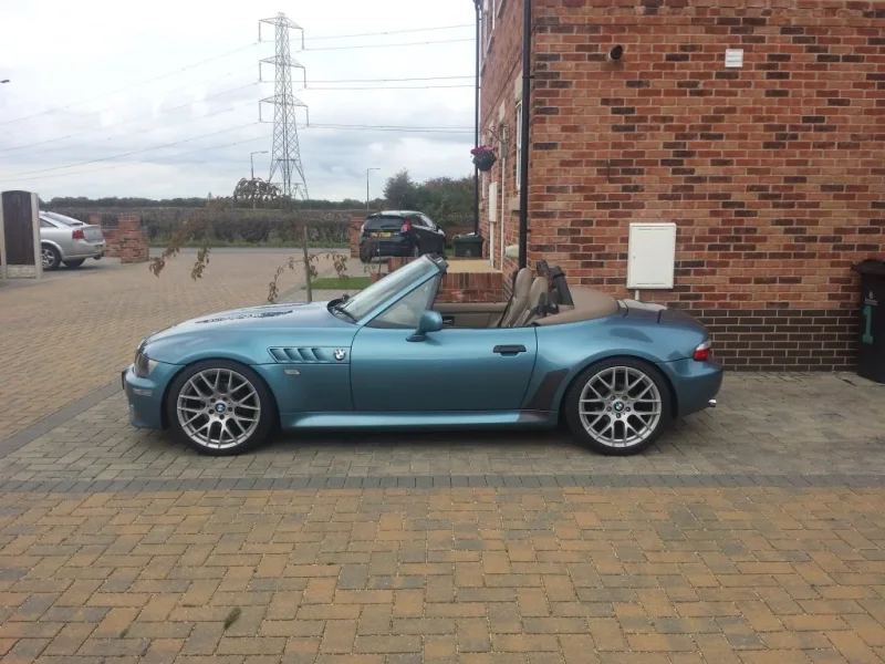

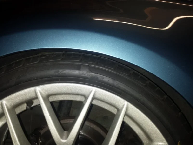

Can't get a great pic in the garage but mine is at tread top20151027_214154.jpg 20151027_214318.jpg
You wouldn't want any more it sits just right for me

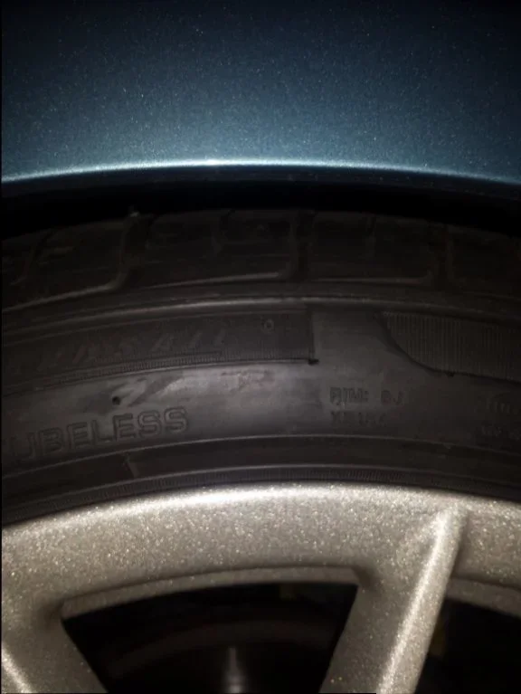

Thing is it doesn't at all the rears haven't caught at all in 300 odd miles they have been fitted.
It was that T-rex that was chasing me Ant. Well that's my excuse, thanks @Andy McDonnell .=)) Yours looks spot on to me Ant.

18's 7.5jj 225/40/18 around offset 35 spaced at the rear a further 20mm.

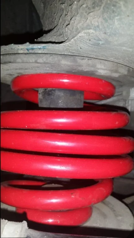

Been told I have the right springs. Should lower the car 60mm when fitted with the adjusters. (there from a coilover set) Removed the adjusters and still not sitting low. Can't possibly go any lower with these other than taking out the pads.

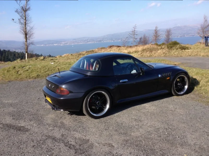

Eibach lowering springs on mine - 40mm drop. 20mm spacers rear and 5 mm front. I get the odd rub if I go over speed bumps too fast otherwise fine on various surface roads.
Tyres: 225x40ZR18.
