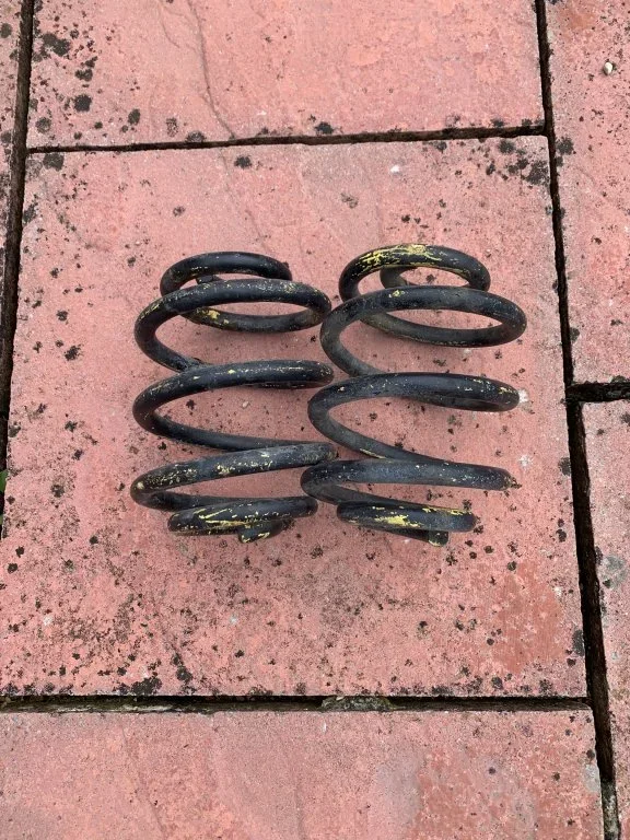

I’m sure I still have a set of rear springs undercover outside, I’ll check in the morning but if your near me your welcome to take them away or I can fit them for you wouldn’t take long.

Hi just checked and they are still there, I bought them for my ///M but was miss sold, to soft. They must have come off a smaller capacity variant but your good enough to get you through a MOT, your most welcome to them. PM me if you want them and I’ll give you my address for collection.
