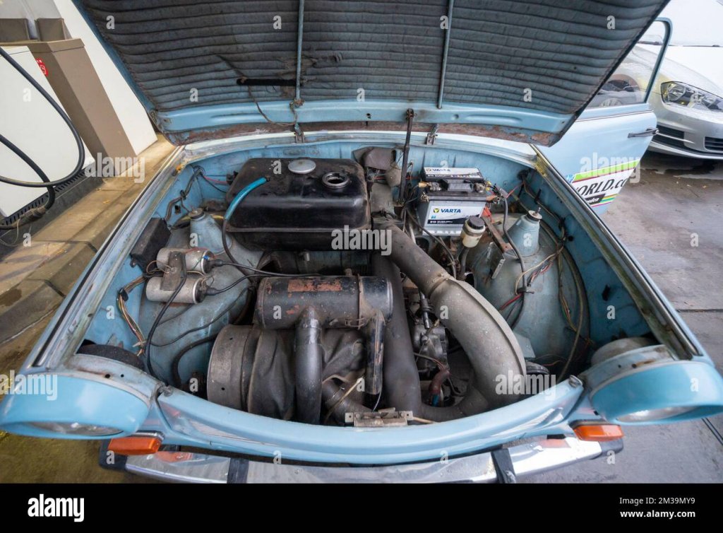

Don't put the jerry can in the boot ----- since that's where the battery lives!
Most cars have their battery in the engine bay------where all the sparks and bangs happen! :)
