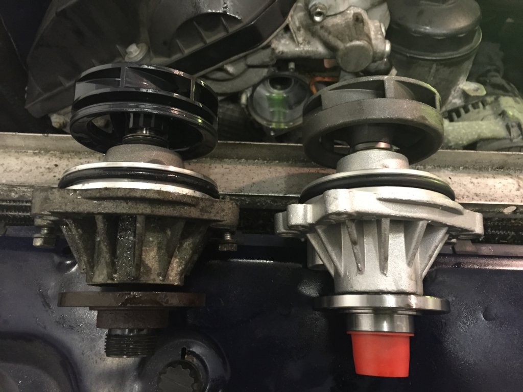

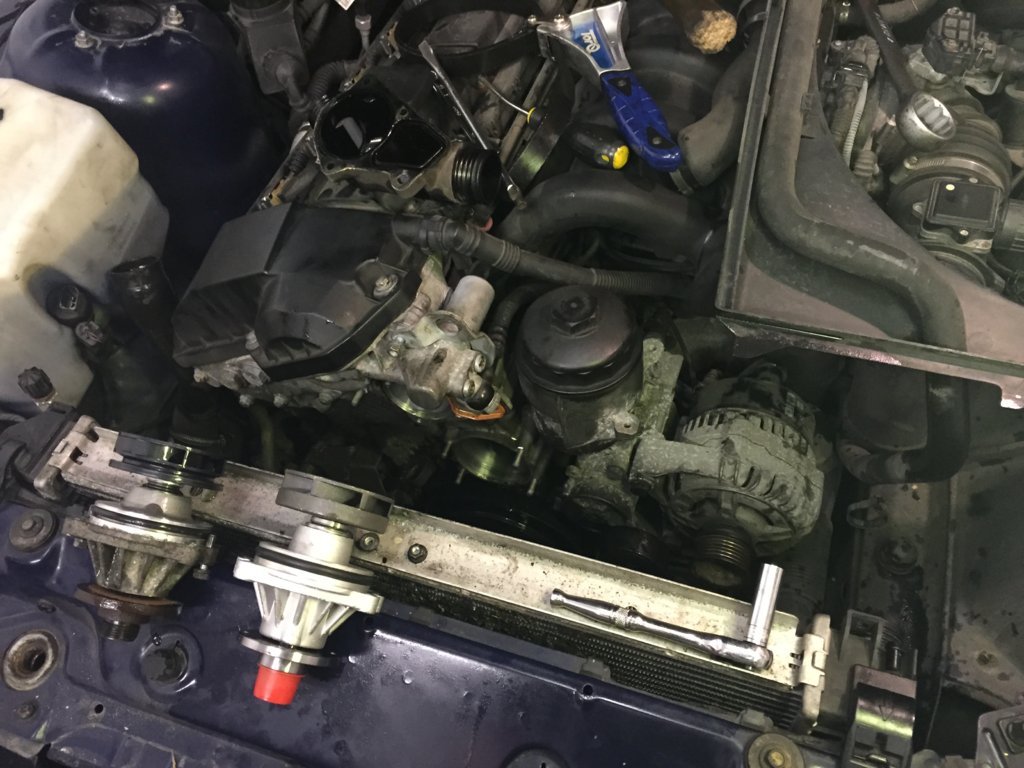

The job itself was very easy. The viscus van has to be removed. The work cannot be done with it in place. I even tried removing everything around the fan but still found it had to come out. So with my huge 32mm spanner on the fan shaft (left hand thread push clockwise) I removed the larger belt and got a rubber grip round the water pump pulley to hold it in place becuase it rotates as you push down.
Photo's show old plastic impeller vs new metal impeller.
Another for idea on location.
Hope this helps.
Hope this helps.
Lee
What brand pump have you used Lee?
cheers
Ash

I will need to dig the box out the bin, GSF stock two types of water pumps. One has a plastic impeller and second has a metal impeller which they call the premium part. £45 on the site but with my trade account its £28. Stick with the metal impeller as this is the weak point in the 2.8 engines.
