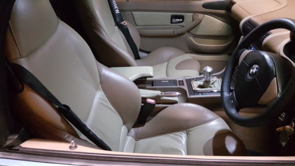

Here's what the seats look like currently.
Note whoever had new covers made didn't have them done in chameleon leather - not a surprise as it's impossible to get hold of. Lotus White appears only with chameleon leather from the factory. The inner leather approximates to BMW Classic (heavy grain) and the bolsters to those on BMW Oregon (not Oregon itself but Oregon uses light grain bolsters).
You may also spot that the colours are reversed. The highlight colour is on the bolsters and is normally on the inner panels.
And if you look really hard you'll see that the bolster to inner seams have been done in the wrong stitching. They should be in a lapped and piped seam and are done in a plain seam. The cod piece has been done in a double-piped plain seam and should be done also in a lapped and piped seam. Yeah I know, I'm getting into this too much...
They will look a little different hopefully by the time I've finished with them. The cracking is not a concern.
