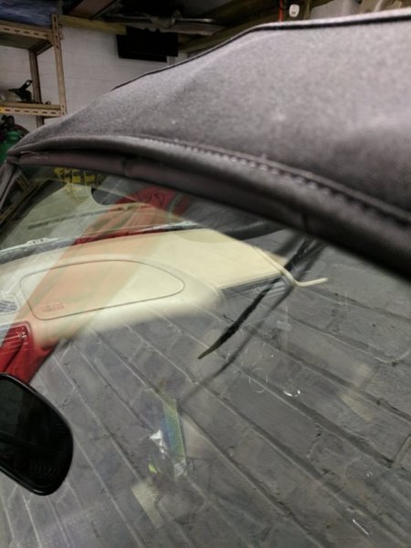

DaveB with a Z3
Aug 19, 2017
68
Thanks all.
In that case how close to the hood should the glass be when fully up. I will try and get a photo of the gap on mine.
