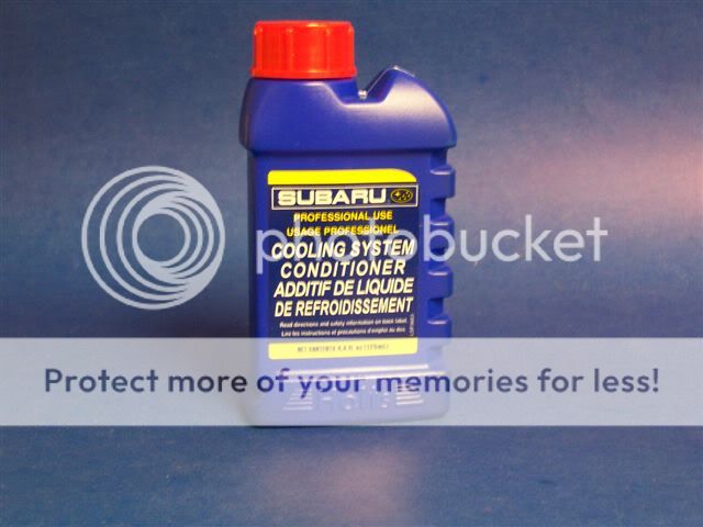

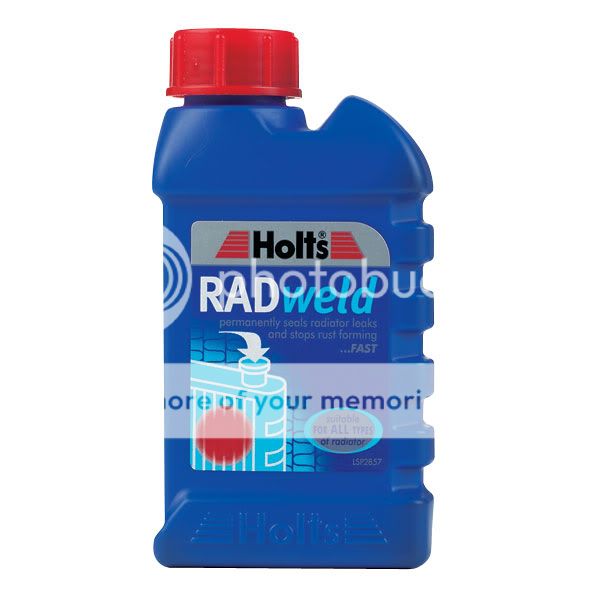

    If I had to use a coolant additive for sealing my Z3, I would use Holt's RADweld, a UK product. It is same as the "conditioner" that Subaru requires be added to their old EJ (pre-2011) 2.5L SOHC engines. It was to prevent (by immediately sealing) head gasket leaks which commonly develop in the EJ engine. The conditioner was required to added to new EJ engines, and at all coolant changes, up to 2 bottles (which are very small). It evidently leaves minimal residue. I use it in my 2008 Forester.
