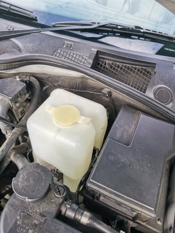

I noticed when I filled my washer bottle up the other day fluid leaking onto the garage floor.
Took the bottle out and could see it had been repaired before by a previous owner..

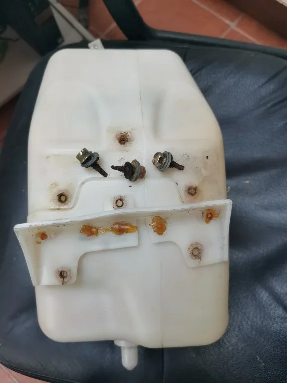

I see from previous threads that they are notorious for leaking where the bulkhead bracket that is attached to it by some sort of plastic welding.

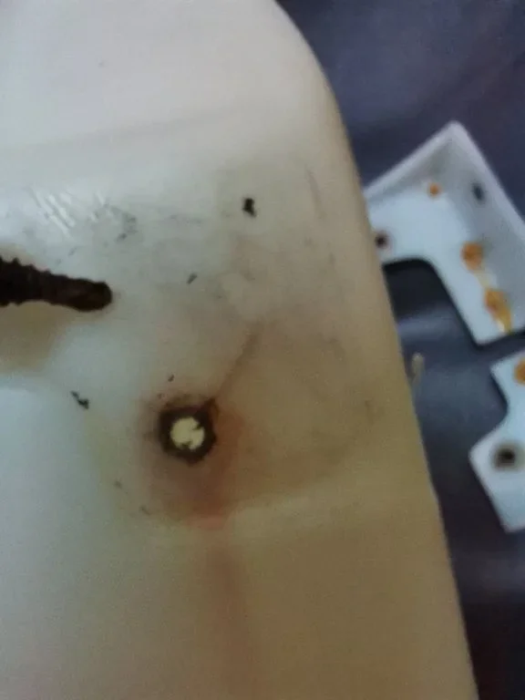

My previous owner had removed the bracket and drilled holes in the bottle and used some rubber washers and self tapping roofing fasteners to attach the bracket
It's leaking from one of these holes.. The fastener appears stripped and has a small hair line crack in the body of the bottle..

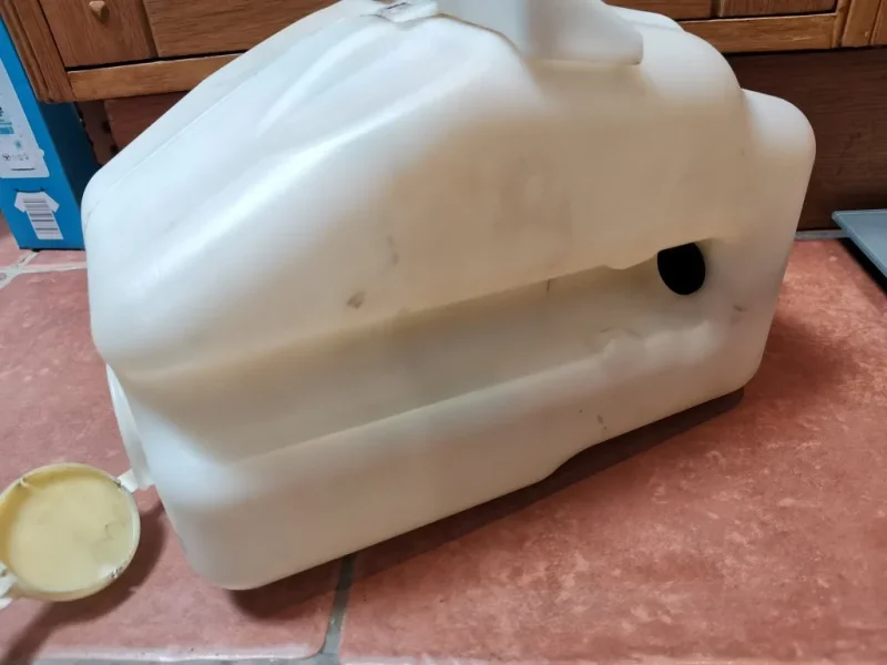

Thanks for all the replies.. What I learned is that
1) Polyethylene which is what the water bottle is made of is extremely difficult to glue onto.. In fact I'm not sure there is a glue that will stick to it.. Melting and welding together seems the only option and I really only wanted to try that as. Last resort
2) Very few Z3's were equipped with headlamp washers and whilst washer bottles for Z3's with a single pump for the windscreen washers are easily available from breakers ones with a hole for each pump are not.
3) I tried the usual suspects on here for one but no joy
4) There is a guy up in Liverpool who breaks Z3's and advertises on Evil Bay and knows his stuff.. He had one which he tested for leaks before sending and quickly dispatched to me. He wasn't cheap but I'm now sorted with a replacement!
