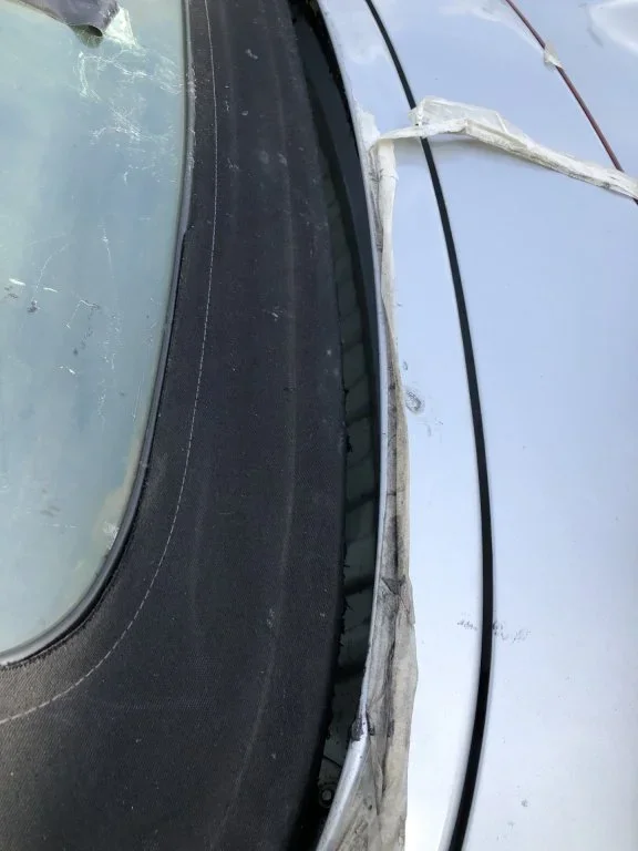

I'm having a bit of a wrestling match with my Z3 roof and refitting it. The roof is a newer roof from a 1997/8 Z3 1.9. and a straight swap. (So I thought). My Z is the same year from the donor car. I have read several articles including TaffZee’ s which .
I have started the refit and come across several problems.

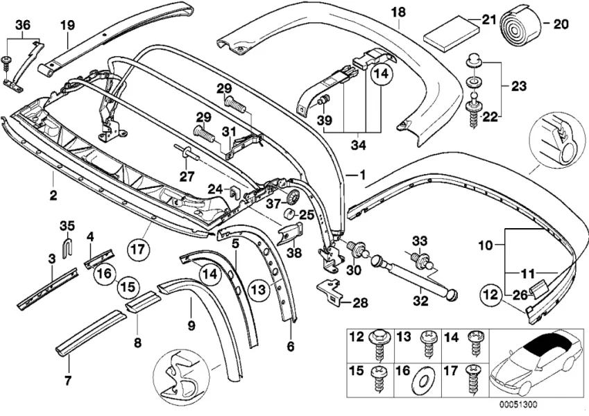

Which holes / where do the 'four bolts' fit on the sealing frame to hold it in place? The roof also appears to be about 25 mm too short to fit in the cavity and attach to the sealing frame. See attached pictures.
I was wondering if the tensioning belts were too short, but considered they must be a standard fitting (Item 19: Real oem picture). If anyone has any further tips or idea’s where I’m going wrong and why the roof is too short for the fit, I would be grateful.
