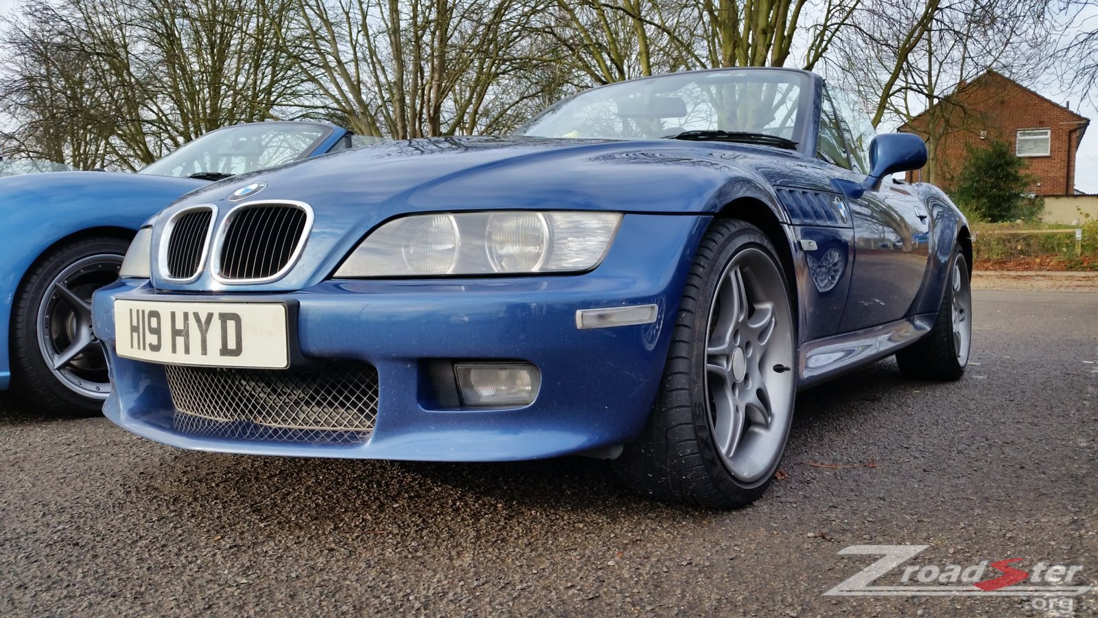

I put my 3.0i on Eibach springs after seeing some of the guys on here do their cars. Went from BMW Sport springs so only about 15mm drop and then fitted some 18" 108 style wheels on Goodyear F1 Eagle tyres. Great road holding, a bit of tramlining on certain roads but front lower arm bushes are on my hit list now. Soon to have new tyres as the wheels are away being refurbished.
