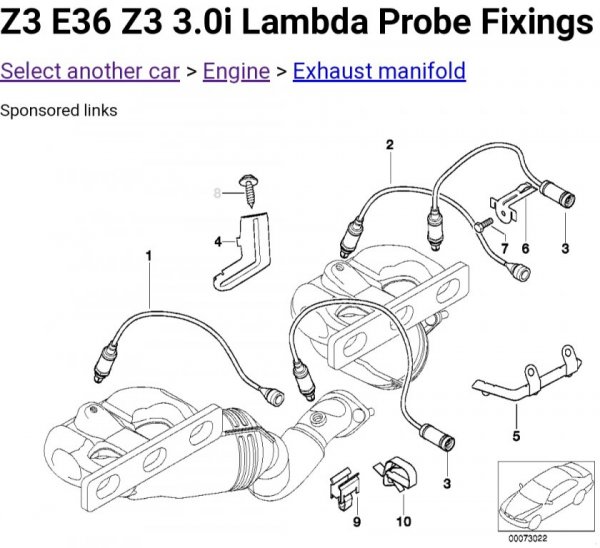

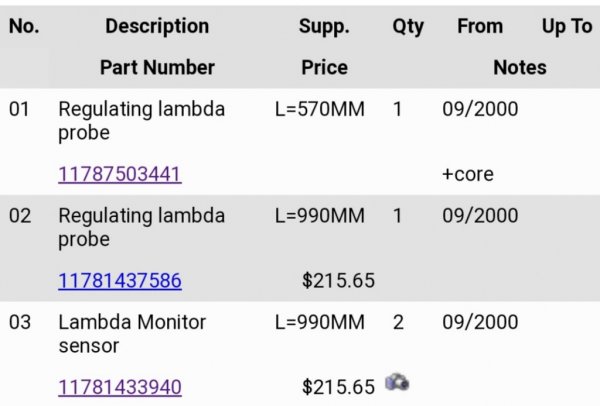

@mrscalex @Mario it's more that three different parts are listed under one item, which makes me sceptical. Length appears to be the probe height, which is the same for bank 2 and both post-cats, but sensor 1 is shorter, so not sure everything would fit :confused:20200619_120919.jpg 20200619_120839.jpg

I was assuming that L value was the cable length and the sensors themselves were the same item - i seem to remember reading people buying BOSCH 3 or 4 wire generic sensors can't remember which ones (cheaper but quality ones) and splicing their own wires with no problem so I recon you should be fine as long as you buy a quality no non counterfeit one if there's extra cable it should be no problem if you route it out of the way, but obviously better if you buy the right exact part.
