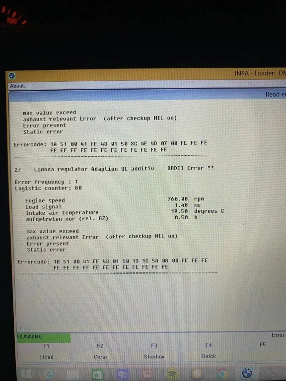

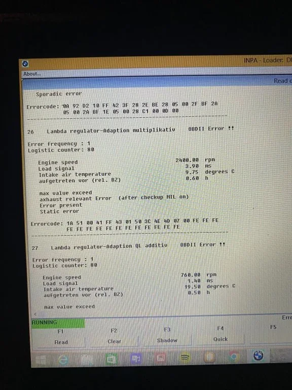

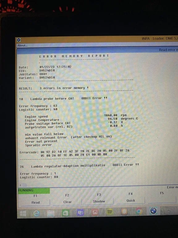

Apologies for the poor pictures just took some snaps of the laptop.
the car has been running off for a few weeks now, and narrowed it down to the MAF sensor. Bought a new one and it’s runs and drives fine.
I went to check the codes on INPA and these 3 were there. (I cleared the codes before the drive after fitting the new MAF)
lambda was replaced in the summer last year. Anyone any thoughts?
