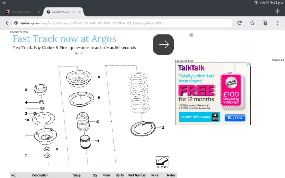

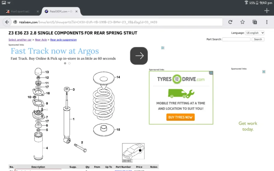

These are all the bits Roy.
Quite a few ontop of your brought kit if your looking for a complete rebuild without using you stock stuff.
I imagine most of the bits would be next day from bmw and the washer etc won't be expensive. The bumper stops etc i imagine will not be that dear either. the only part i would think would be would be the top hat and that may surprise too.

Ok Ant, thanks again, it'll defo get what we think should be replaced, no sense in using old stuff if we got to do it all over again next year because something old isn't up to it. :happy: Thanks again for the gift, I'll post pics for your opinion when it's done.:snaphappy:

On the front the two bolts that attach the shock to the kingpin are meant to be onetime use and to be fair they do get as rusty as....
On the rear, if you are changing the drop links the nut/bolts also take a pounding, have a look at your rear shocks at the bottom mounting hole/tube, on the OEM shocks the mounting tube through the shock is elongated, many aftermarket are not, this is not an issue if you have a small spacer to hand. If your rear shocks are for the bucket, you can saw off a section of the bottom tube to create a spacer if needed :) without the spacer the OEM bolt will be too long.
A tip when changing out the rear Spring is to release the rear ARB from the trailing arm, this will allow the trailing arm to drop enough to allow the OEM Spring to come out.
If I can think of anything else I'll let you know.
FYI I've just bought nearly all the sundries above for £90 from sopers Lincoln
The top mounts were half price at gsf compared to bmw (lemforder)
Bumpstops and gaiters came from eBay.
