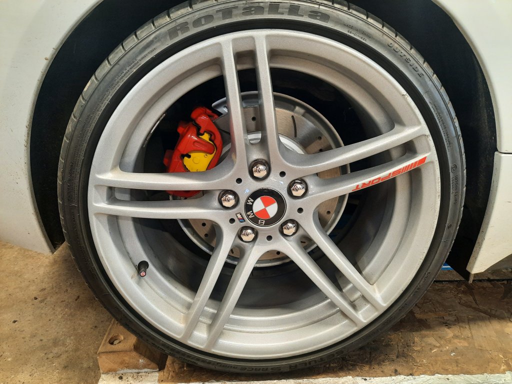

Kai’s been waiting a while for us to have a look at his 2.8. Also strangely picked up a couple more extra faults after others have played with it recently. Saturday we got her in and up in the air, found out pretty quickly various issues and their causes. We’re going to give everything a refresh but no powder coat this time, we have a strict budget to work to.
first up we pulled the subframe to see the extent of everything. little crispy.
going to give everything a clean up and she how it all fairs
some of the worst bushes I’ve seen
normal handbrake cable condition
we found the source of the vibration when engaging the clutch. These Bluetooth edition gearbox mounts, trouble is these have just been off as another garage had fitted a clutch.
bit of cleaning up to do at the rear.
once seized brake line
some interesting installation of bushes. Not the correct orientation either.
