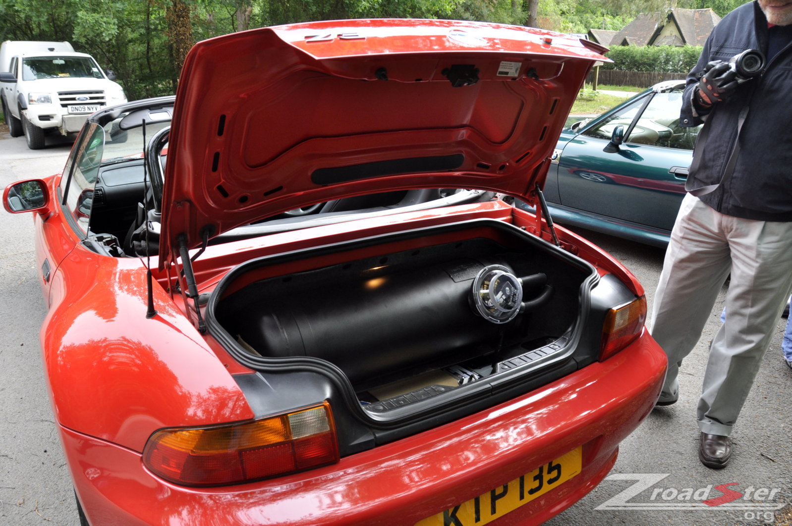

    My only contribution on the LPG side of things would be this picture of a car I saw some years ago. He seemed pleased enough with his system, sorry I can remeber more about it though...

    Thanks for the info. I know LPG won't be for all, but I do enough miles that it'd probably pay for itself in a year. And 50+mpg fuel bills would be nice when you factor in the cost of LPG.

    4. I have no experience of LPG but you could remove the spare wheel which is located under the boot (most will be in a poor state now tbh so no loss) and use a donut tank hence saving on boot space. MPG wise upto 30 is easily achievable dropping to around 25 in town so is quite a good compromise against the potential performance that is available.
