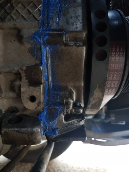

Some of you may have seen my previous post regarding the fact that my Z3 was in the worshop to have the head gasket replaced. Originally the job was meant to take 4 days, but after 2 weeks and a lot of broken promises I finally got it back today. Paid up (over £1000) and drove home.
When came back down to check everything they'd done and there was a big puddle of oil under the car. Upon further inspection it looks like they've incorrectly fitted a gasket, causing the leak and with a liberal application of sealant managed to conceal their tracks long enough to fool me as I paid and left their premises.
What should I do? I've already called the bank and they can't cancel the payment, though they can try to claim it back after the funds have cleared. Should I contact the trading standards agency?

Which gasket is leaking oil ?

Looking at the picture Shane I'm with you. Wouldn't want them working on my car again! Did they paint that on with a brush after it had been closed up?
Unfortunately I fear you're into territory that's going to take a long time to prove and resolve.
I'm kicking myself, if I'd just opened the bonnet I would have spotted that a mile off! It's bright F*c*ing blue

Main seal, on the drivers side edge at the water pump pulleys.
I'm not fully familiar with the 2.2 engine (M54?) but I is that the vanos casing seal? If it is, it's not a major job to put right unless they've f*****d the mating surfaces either dismantling or assembling.
I've just changed the head gasket on my car and other than the cylinder head gasket and rocker gasket the only other oil retaining gasket they'd need to touch is the vanos seal
By the way, the vanos casing will be directly above the pulleys
I dandered in during all the delays and made them show me the progress they'd made. For whatever reason they'd stripped off most of the front of the engine. I'm pretty sure it's the main seal. Though I hope your right.

It looks like the timing chain lower cover, at the bottom of the engine. Not sure why they would have removed that unless they took the chain out completely.
A couple of pulleys, fan and belts to remove to get it off again. The gaskets are metal so should really have been replaced as they deform on tightening, and would not be really re-useable without sealant. but sealant should be on the mating faces, and not bodged up the side of the casing afterwards, because that will never cure a leak.
