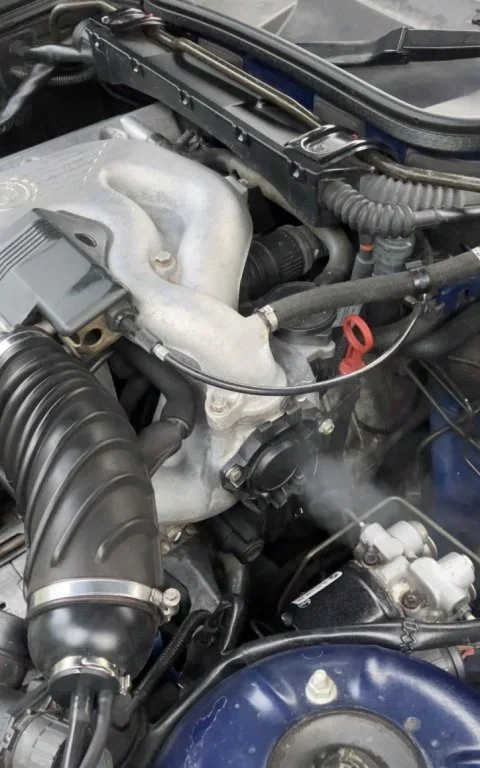

The Z3 was making some unusual noises, possibly coming from the intake, and the fuel trims were also looking a little out so I decided to run a smoke test to see if I had a problem. Seems like I do…

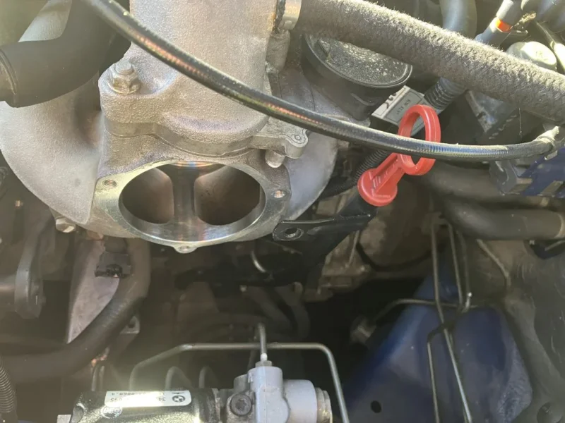

It came off easily enough:

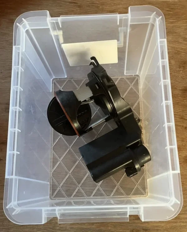

Definitely easier but if I can do it myself then I’d feel happier than having someone else screwing around with this part. It may be that I make as bad a job as seen in some of the YouTube videos, in which case I may go for a used working part or, worst case, a refurbed unit.

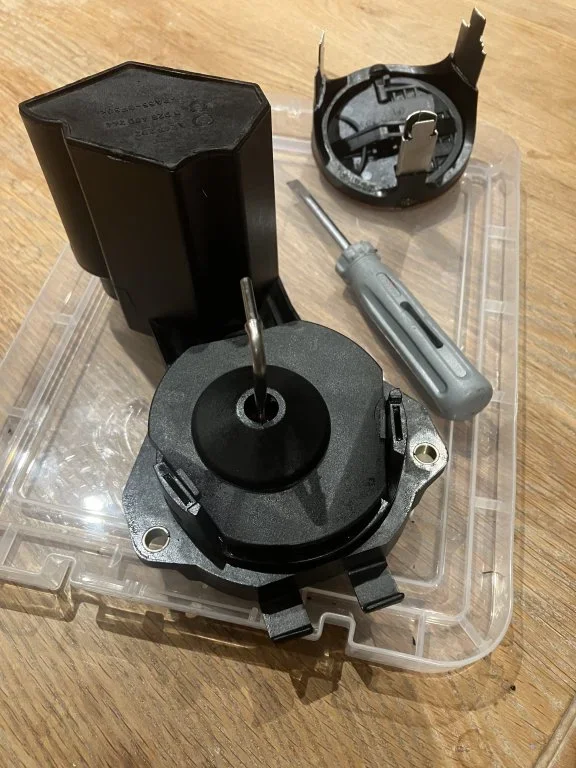

So far, so good …View attachment 354567

No, I haven’t found a good source for the parts yet. There are parts available online but with no information available about the materials. When I’m back in the office I’ll speak to a materials specialist and see if our regular supply chain can come up with anything. It’s in a harsh environment and a parts failure could possibly end very badly.
I found on the 3 Disa i rebuild i found the larger Clear/white diaphragm was ok it was always the orange/ red one that was damaged.
On rebuild i put grease in the hinges for flap which also seemed to help
Yes i had same problem the diaphragms if i remember ones i got came from Usa
Had to buy pack of 3 ( but luckily i had 3 disa to rebuild) the 2 that are still in thier respective vehicles still ok since repair.
