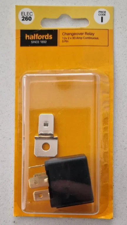

Replaced both pink topped relays this morning with two of the attached relays from Halfords.
They both have identical pins and the pin numbers are in the correct order.
However there is now a delay (3-5seconds) before the pump engages.
I guess there must be something significantly different with the OEM pink topped relays ?
