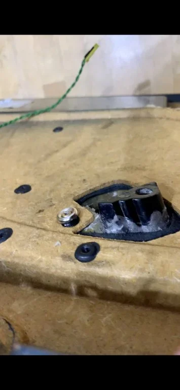

Just to elaborate. I used an decent plastic solvent I picked up from screwfix. Did a great job welding the plastic inner parts. I glued it all back in place and was okay. The best thing I did was screwing directly in to the door handle right through the center of the little plastic locator that’s welded to the back of the door card. I drilled through this from the back with 3mm drill then a 1mm pilot hole into the handle. A 25mm self tapping screw with cup washer went in and it’s better than the original now. Hang yer granny off it!
I just had the interior passenger door handle "pull loose" on the "top section", and it looks like it pulled "right through the original screw" that went into the door card. So, your concept of "creating your own hole/place to re-screw it into the door card, plus adding some form of plastic solvent/epoxy/glue/etc. , sounds like the way to go. I'll let you know how it works. Respectfully, "Stands with Loose Door Handle"

The problem with the door pulls is the material which all the stress is directed is plastic and thin, and it is used every time you close the door, so it is going to fail at some point. After looking for a replacement, new (absurd pricing around $200) and used (almost as much a new one), I decided to try and repair the original. I repaired my drivers side with a combination of "plastic weld", reinforcement, and an additional screw to spread the load. The reinforcement consisted of creating a small sheet metal "tab" to sit in the pocket where screw goes (to help spread the load), a small washer may work if the plastic is not yet damaged. Additionally I added a pair of cut-off wire brads between the 2 broken pieces of plastic to help hold the pieces together for the plastic weld, I applied the plastic weld on both sides of the screw pocket with the reinforcements in place. Before I reinstalled the door card I added an additional screw with an oversized (fender) washer from the backside of the door card into the top section of the door pull to help spread the load on the pull to both the door card and the original screw. I can say that after the repair, the door pull has never felt stronger and it convinced me to proactively reinforce the passenger side pull as well before it could fail.
