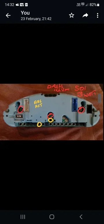

This may help i screen shotted this agaes ago from another thread to highlight certain bulb positions for a new member may help with positions of the bulb in question.
Also could be worth pulling out the clocks taking out offending bulbs clean connection refit as could have a bad connection with vibration over the years.

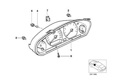

Hi David
RealOEm: https://www.realoem.com/bmw/enUS/showparts?id=CH32-EUR-09-1999-Z3-BMW-Z3_28&diagId=62_0308
Bulbs:
1.2W: https://www.schmiedmann.co.uk/en/product/1965490-new?product=62-13-1-383-311
1.5W: https://www.amazon.co.uk/instrument-cluster-Bulb-Beige-Socket/dp/B00D03YYUG?ref_=ast_sto_dp
W3W: https://www.schmiedmann.co.uk/en/cata-ol?q=9905358#
You can get LED versions, but lumenance varies. These are not neccessarily the best prices!
