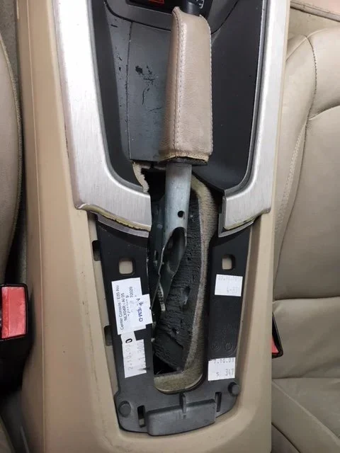

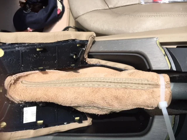

Thanks for reply Paul, I may give it a try today. The new boots are from my daughter for my birthday so I told her I would install them and take a picture for her.Fortunately both items can be replaced without removing the console. The handbrake surround lifts out, no clips or screws. Boot is secured by a tie wrap, clip off and remove, note the boot is secured inside out. New boot secured with new tie wrap. I have the manual transmission so not sure how the gear selector is fastened. Instruction manual says the Knob just pulls of with a good vertical tug, absolute rubbish never known one come of that easy. Gear lever boot fits around the inner of the surround on the manual, not sure about the auto.

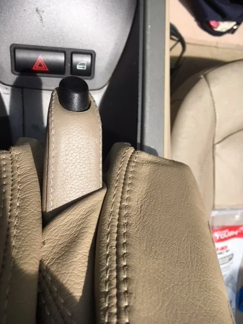

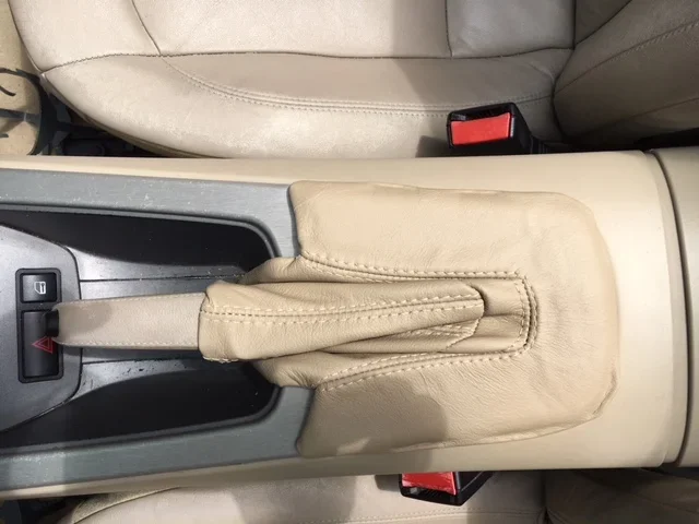

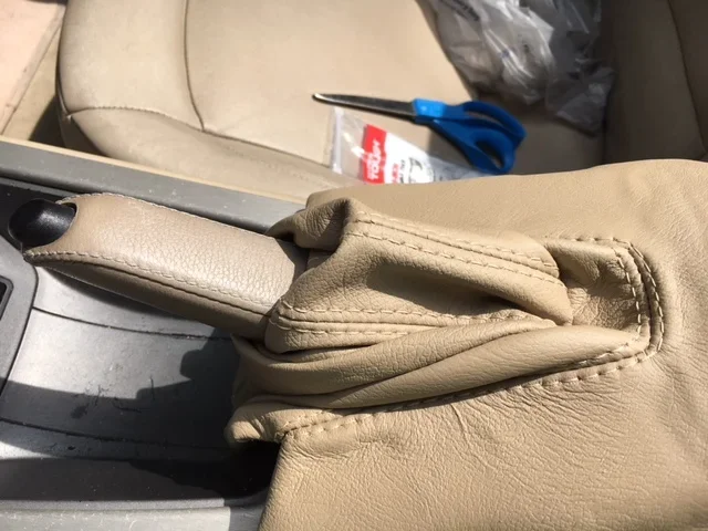

Please find attached pictures of my project to install a new leather cover for my E brake on my 2004 Z4 BMW. The old leather was actually in good shape but was very faded.Post the pictures on here Leon

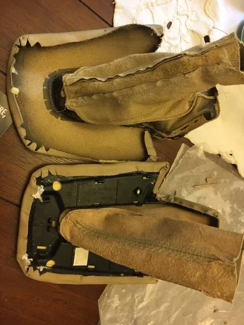

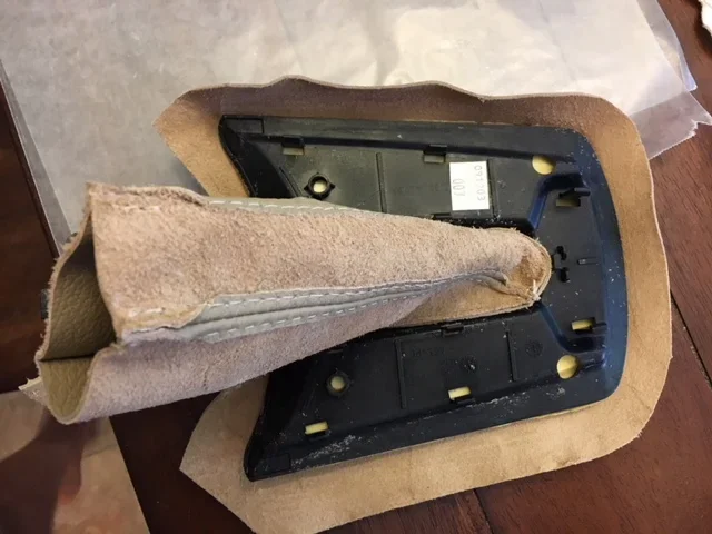

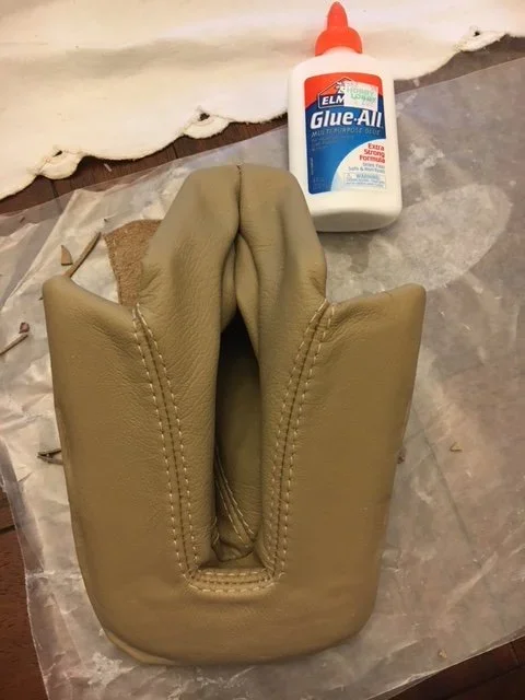

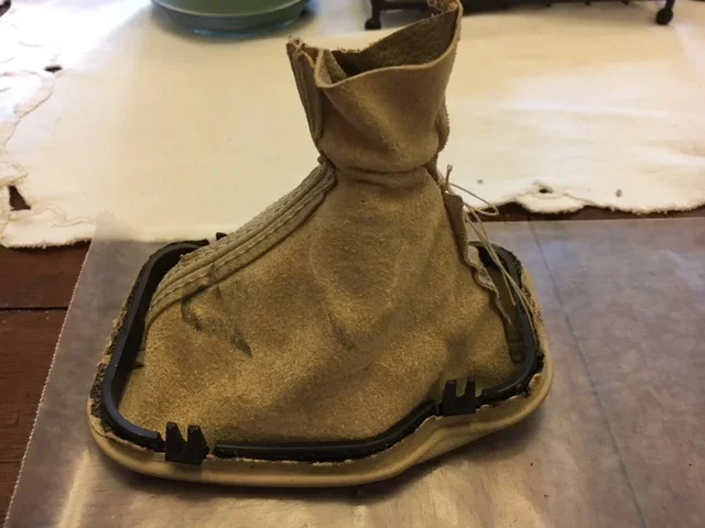

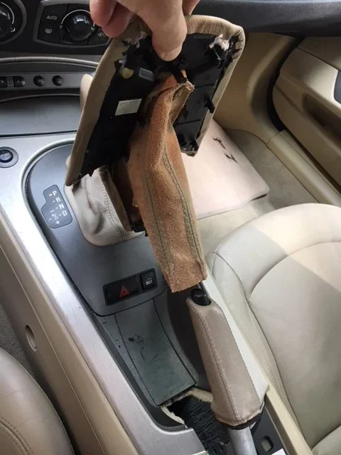

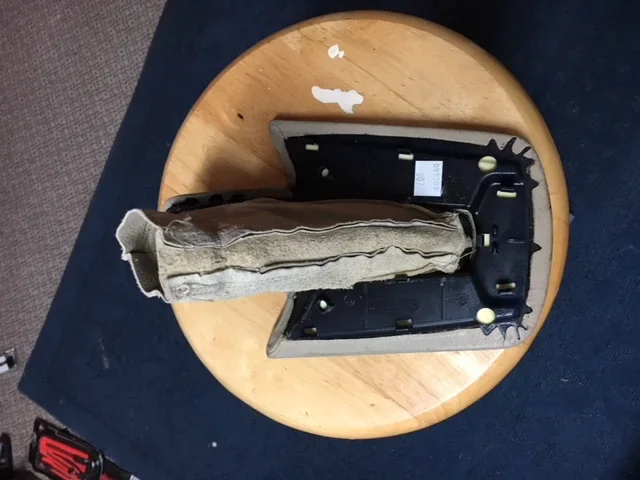

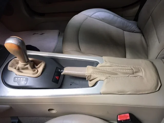

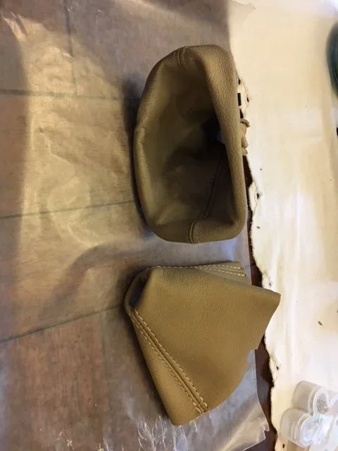

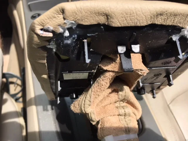

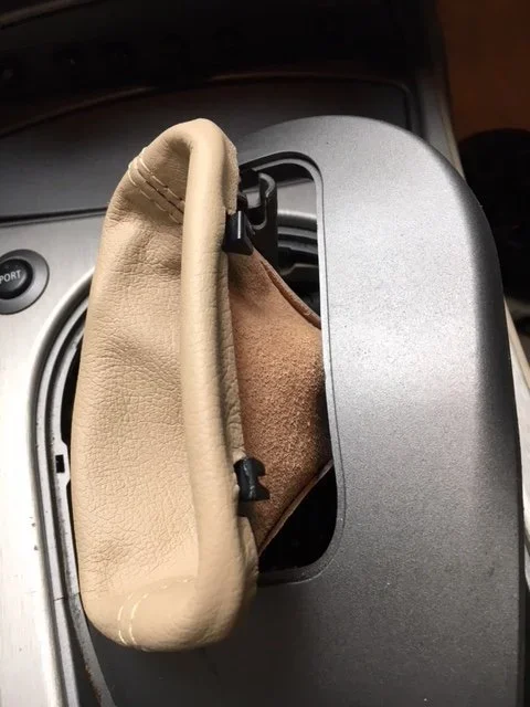

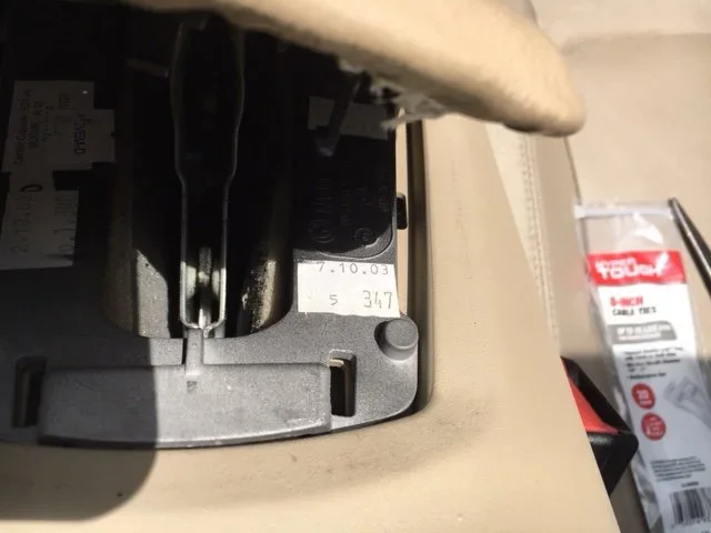

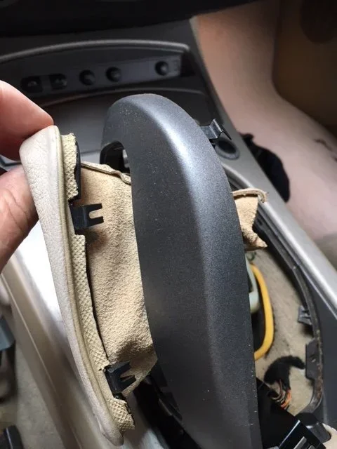

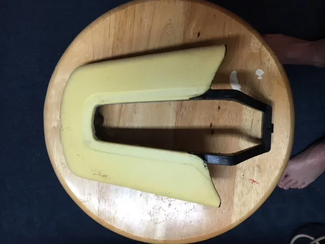

I replaced the shifter boot on my 2004 Z4 today. It was not a bad job however the main issue I had is that the new boot leather was thicker than the original boot leather and I had to trim the leather so it would fit into the plastic frame. The good thing is that in the E85 Z4 series anyway, the shifter housing, shifter and boot just pop out. In the pictures below I try to show the steps. 1. Pull Shifter out while car is in neutral, pop housing off but DON'T unplug two wires that plug into housing - leave housing there, remove old boot housing & boot. 2. Take pictures of how the existing boot housing fit together and example how the old boot is glued to the plastic boot housing and try to duplicate the gluing of new boot so it fits back into the shifter housing easily. If new boot leather is thicker it may be difficult to fit it into the housing. 3. Remove old boot and clean clue of plastic boot frame. 4. Glue new boot onto the plastic frame LIKE old boot was glued. 5. Re-install boot & frame into the shifter frame. 6. Pop housing back into console 7. Pop shifter handle back into shifterGood Job Leon
