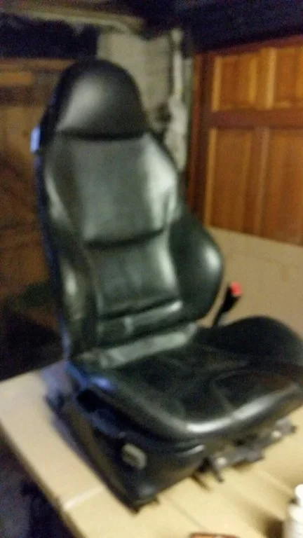

I bought a set of facelift sports seats from Steve @Low Rider a couple of months ago and intended to have them fitted by now, but weekend home jobs, bad weather and a touch of the "I can't be arsed" delayed the job until now.

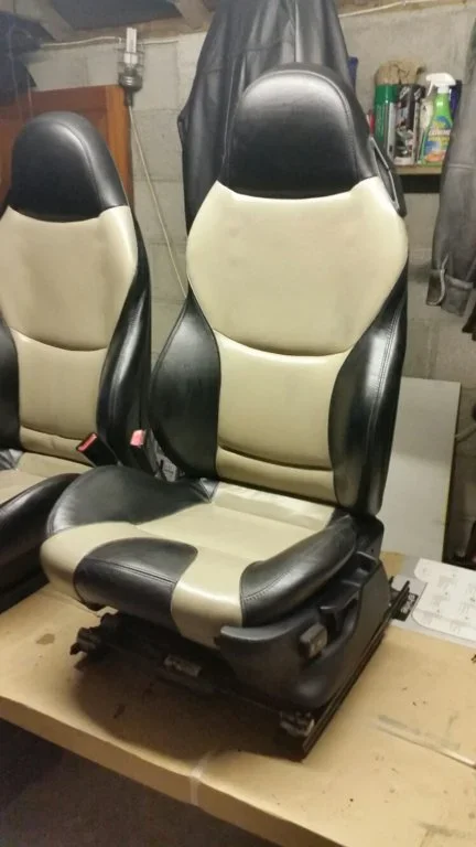

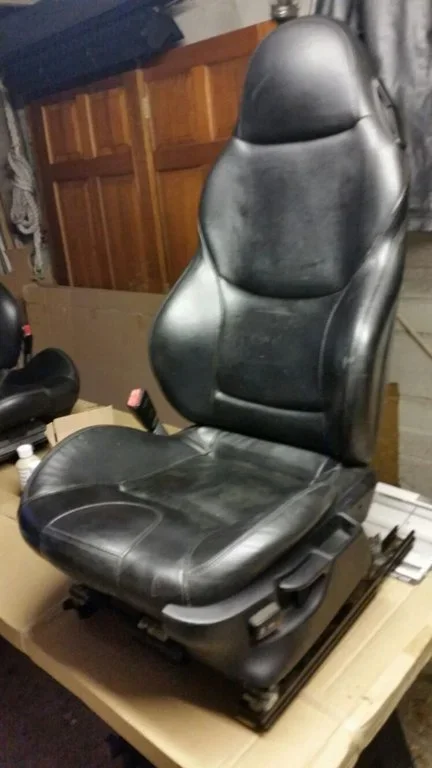

Steve had had them in storage for a while and told me they needed a good clean, but they weren't too bad.

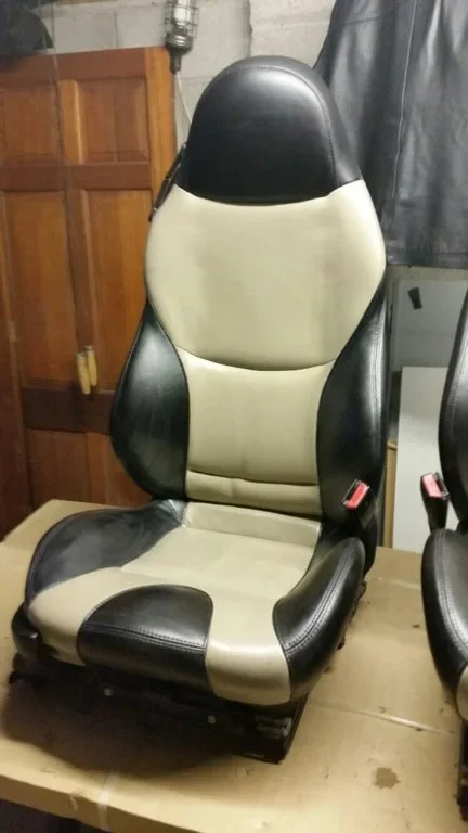

I did an initial clean and a couple of easy repairs with the help of a leather refurbishing kit from "Scratch Doctor" and decided I was going to attempt to create a two tone look that's favoured by many of you fellow Zedders.
I decided mine was going to be black and beige so had a go and this is how they turned out.
The beige is a little light compared to the rest of the interior but it'll do for the moment.
The recolouring is pretty easy but in my haste to get it done I found that I didn't pay enough attention to the initial cleaning process. When I was putting the beige colour on the seat I found the fluid was "splitting" which meant that I hadn't removed all the grease deposits that had built up over the years, but I'd started so I thought I'd finish it.

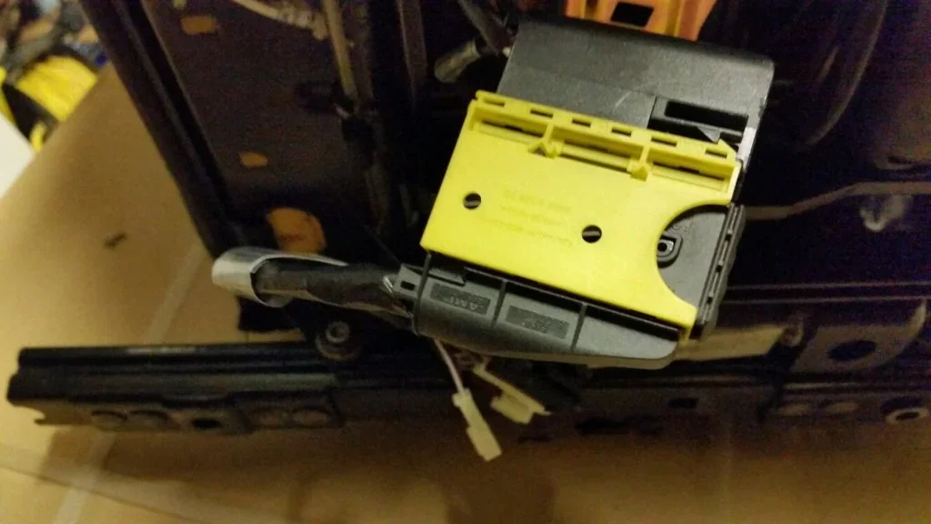

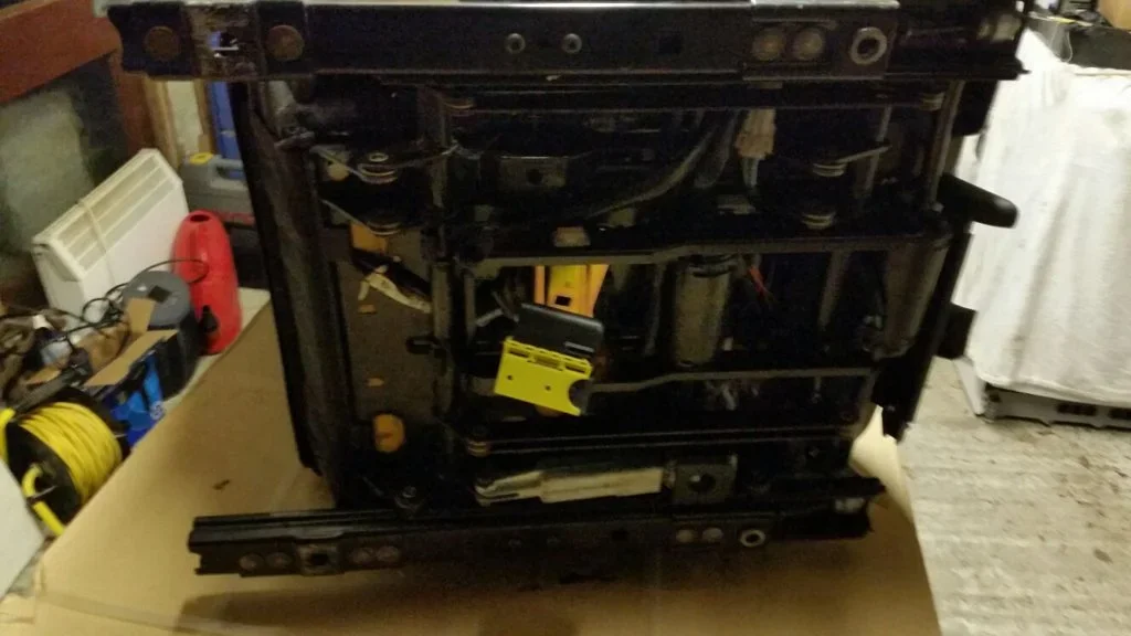

On the underside of facelift seats you'll find one big yellow plug

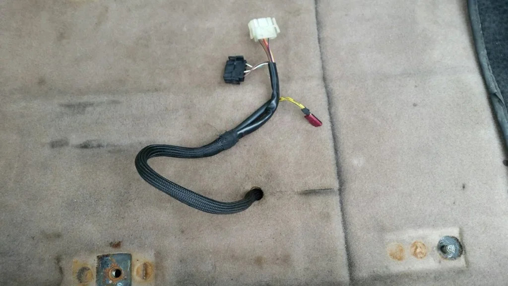

and under the seat of a pre-facelift car you'll find a different type of plug, and to make it sort of complicated, there's actually three plugs

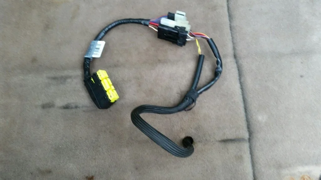

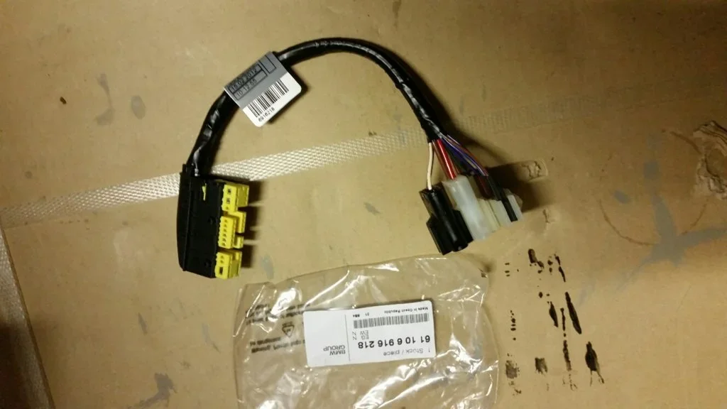

From here you have some choices, you can either cut the plugs off and join the wires if you can sort this type of thing yourself, or you can do what I did and buy a couple of BMW purpose made wiring looms. I bought these from Soper's @Soper Parts Lincoln . They aren't cheap at £52 each, but it means the job is "plug and go". BMW part number is 61106916218.

The yellow bit fits into the yellow bit like this
and the other ends fit together like this
Easy peasy.

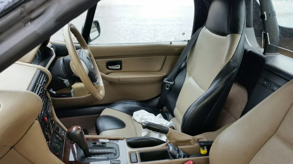

So, then you just fit the new seats into your Zed, connect the plugs as already described and Bob's your uncle, Fanny's your auntie and job's a guddun. Job done.
Just got the one in then it started to rain so I thought I'd come in the house for a cuppa and to start putting this on the forum.
When it knocks off I'll go out and fit the other one and I'll take a top down pic of my updated Zed.

Excellent job Garry, they look really smart. As you said it's becoming a fashion to two tone the seats and I like what @MAURICE THE MARTIAN has done with his Z4 so maybe something for the future, when I don't need the car every day, or if I come accross some reasonably priced seats. Maybe even a set of sport seats.
Nice job ! I found it quite a satisfying process its time consuming but worth it. The cars looking well it may have taken a while but worth the wait :thumbsup:

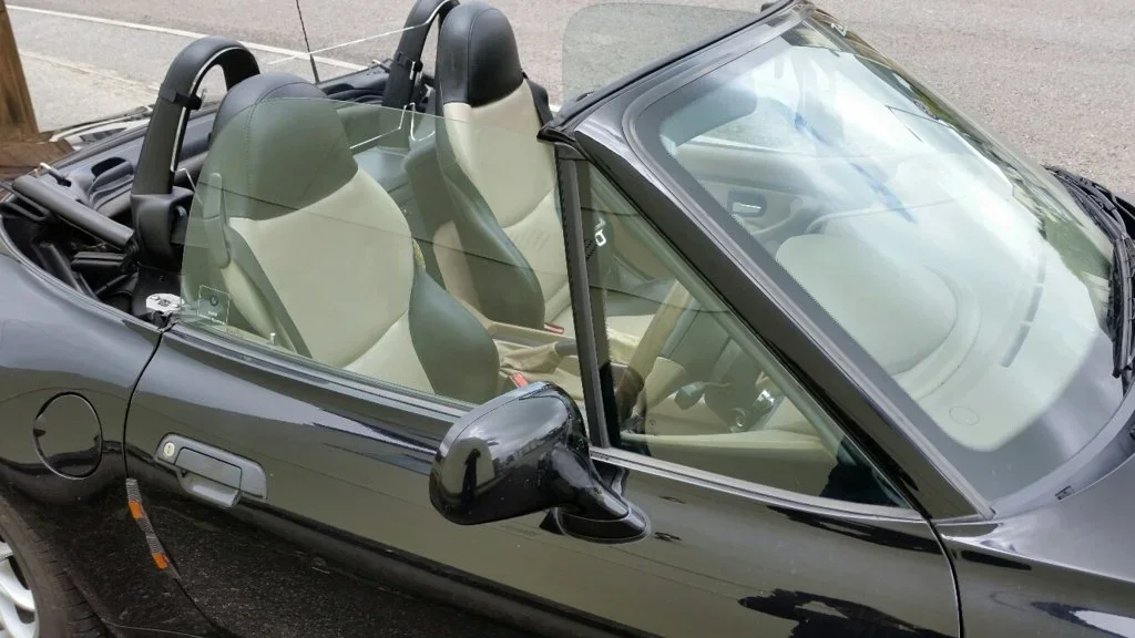

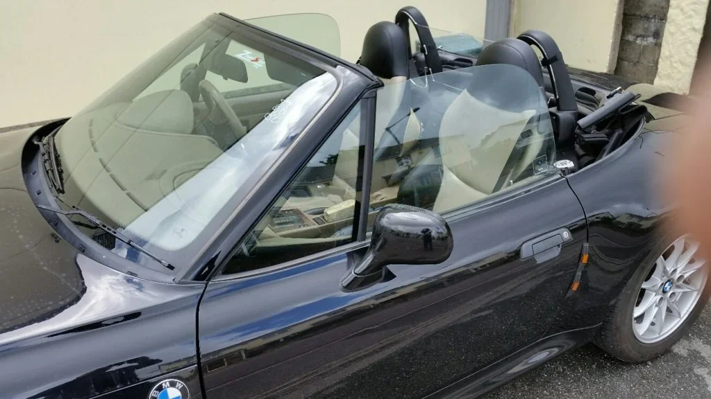

Thank you for the kind words, here's the finished job
Did an oil and filter change and air filter too yesterday. Getting ready for the Euro trip in 2 weeks time
Looks great, and a good write up too! I've quoted the part number for the wiring loom lots of times, but thats the first time I've actually seen a picture of one
Just edited my post to show the part number which is on the plastic bag in the photo.

wow, this leather coloring thing seems to give very good results...even light colours on black! Very good job, I am more and more tempted to give it a go myself!
