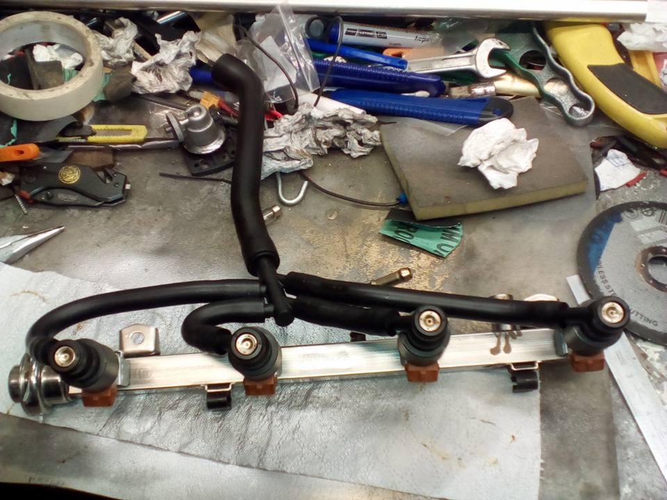

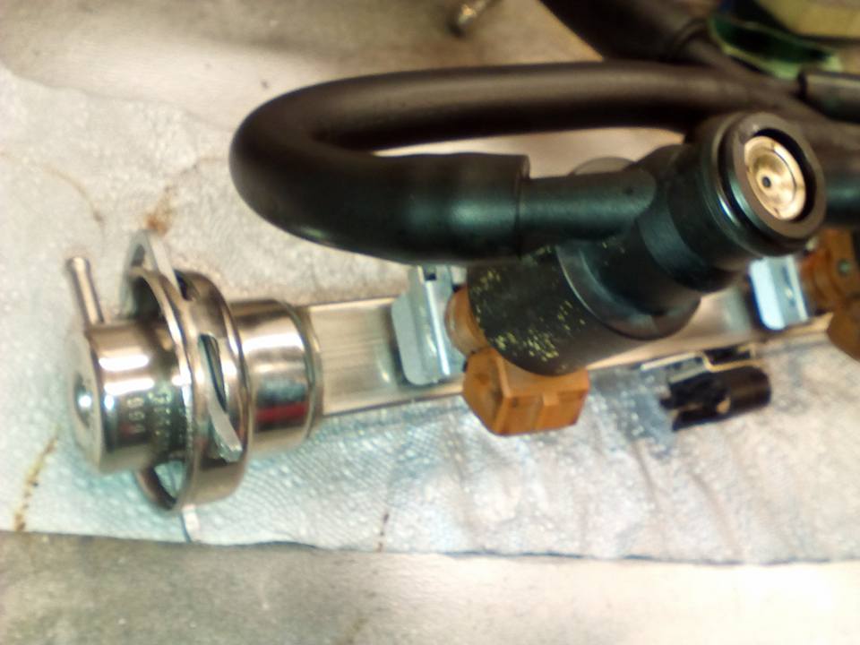

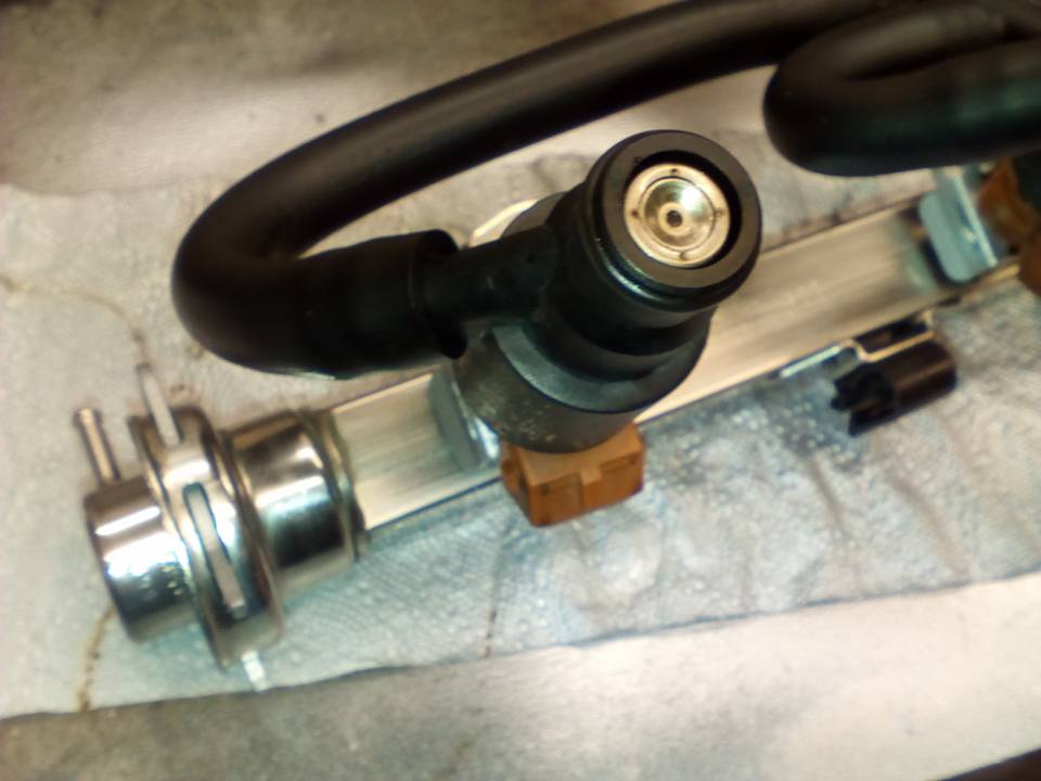

I removed my injectors and had my mate to ultrasonic clean them in his workplace local college motor vehicle dept.. they were flow tested too and were very bad. but once cleaned were spot on.. i should have took some before pics but heres some after pics...

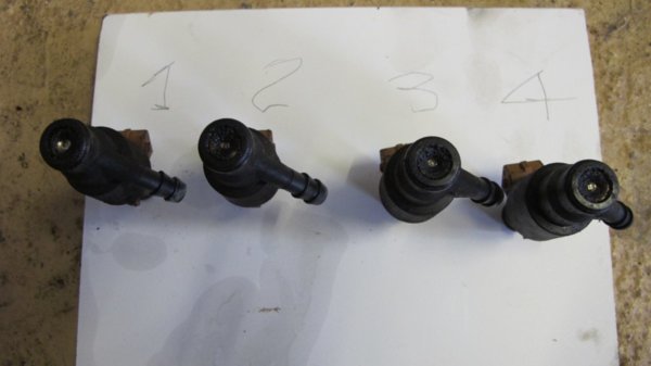

Nice job - did your before look like these. Mileage was 73k. Fitted reconditioned units in mine.View attachment 85164
yeah looked very similar to that i was shocked how dirty they were.. but my mate did a cracking job on them in the ultrasonic tank, he also run them on his flow rig and said they were pretty well matched in flow

Do you disassemble them before you ultrasonic clean them? I have a ultrasonic cleaner on my work, our saw doctors using it for their parts. Did you noticed a difference in driving?
