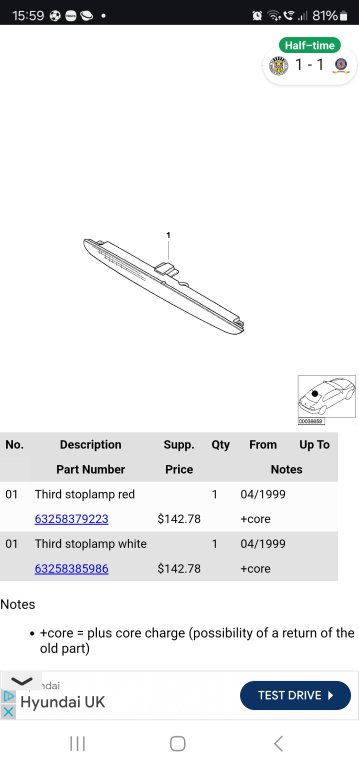

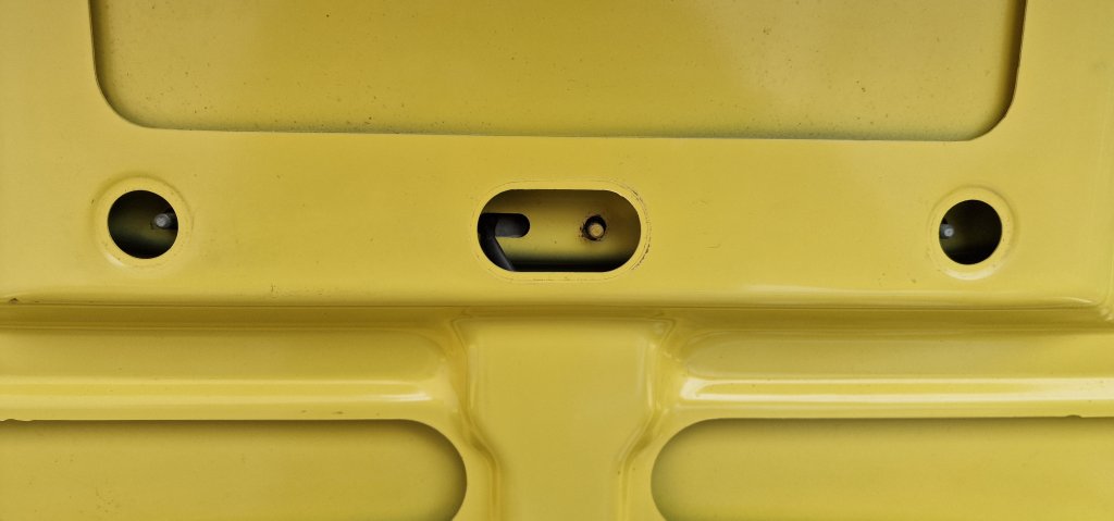

Bought third brake light seal from BMW for garage to fit whilst car having work done, to be told it's not the right seal. Putting up the part number for someone to hopefully tell me one way or other? Long story short, it's a 1998 Z3 with a facelift rear.

If you bought it from BMW they likely asked you for your registration number or chassis No.
But you say you have a face lift rear? So you have a 1998 car with a much newer facelift boot lid?

Real oem doesn't list anything only the pre face-lift has a proper gasket.
The face-lift will only have rubber washers at best and maybe a wiring grommet
There is not a big hole in the boot lid on the face-lift model.

That one? I don't know if thats a seal between the lens and the body of the light. Or between the light and the bootlid on prefacelift.
Best to take yours out to see what it looks like.

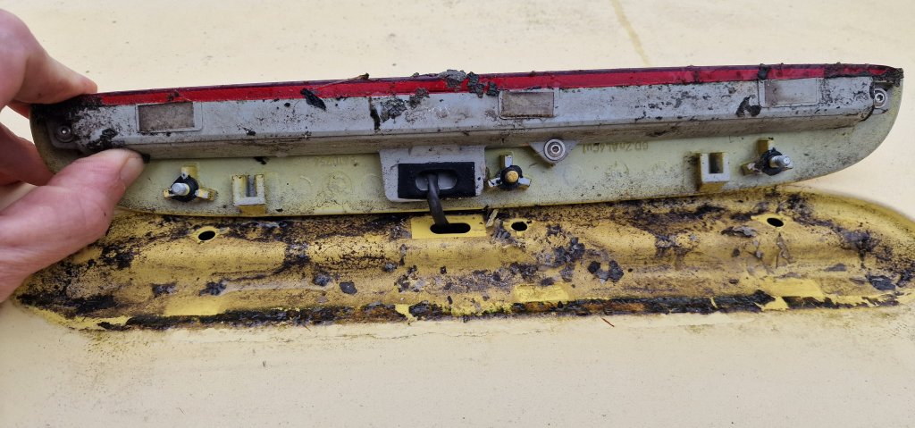

Pre face-lift model gasket.
Just ripped out the one on the dakar in drive
Face-lift model has 3 rubber washer at bolt points and square rubber pad at wiring point all part of the light unit
Amazing how much crap under there

Thank you so much guys, clears that one up. Very much appreciated.
Free gasket going to a good home, free of charge, 1998 Z3. Thanks again.
