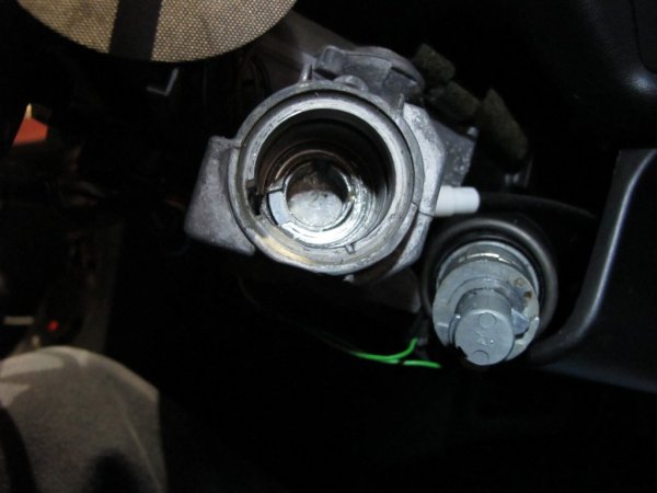

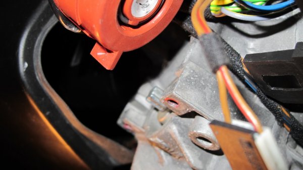

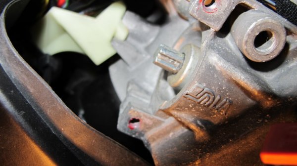

If you google spinning lock Z3 you will find a number of You tube videos explaining problem and how to remove lock, barrel or switch. I'll try and find you some links. Your symptoms sound like lock or barrel not actual switch. Mine does this on occasions, and I manage to reset/re-engage it by removing switch and turning barrel shaft. See pics B3DF1174-1D9D-4FC2-9F16-97F830A835DA.jpeg43DEE58E-2F60-418F-BC41-5DF96572817E.jpeg

Many thanks- bang on advice! Removed ignition switch, turned shaft and all back to normal! :)

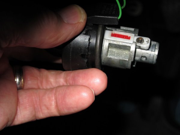

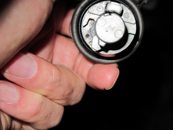

Well done - unfortunately no guarantee it will not happen again. May be worth extracting ignition lock and checking for any wear or swarf in the barrel. Pics show barrel with lock removed.
8EC85EAB-6797-4768-89A0-D310C4EEBCE0.jpeg 3705E894-9AF1-4818-9723-6552120CD571.jpeg
