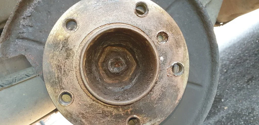

Hi all,

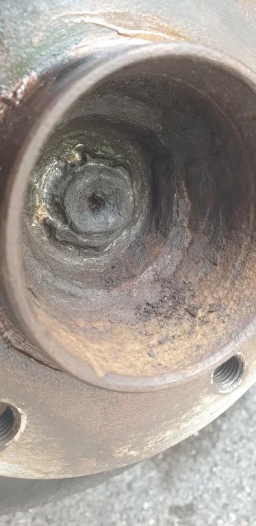

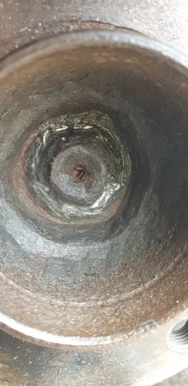

Just wondering if anybody has ever come across their hub nut being welded in place by a previous owner? Just started the work to replace my rear offside wheel bearing and found that the hub nut is completely rusted and appears welded in place. It appears to have originally been a 6 point nut, which I believe is non standard anyway, with 30mm 12 point being standard. I am now beyond the point of no return as I've been carefully trying to use a Dremel to cut through it which doesn't seem to work as it's welded all around so shows no sign of coming off. I've used an induction heater over the nut which made no diference whatsoever.
I'm now thinking I'm going to have to angle grind through the hub, bearing and cv shaft to get the thing off which seems a bit drastic and I'm not sure who could provide a new CV shaft; checked autocs and a few others and they don't have any, so... stuck!

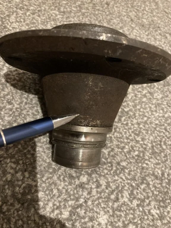

You will have to use a grinder to cut through the hub flange and grind enough of the nut away to be moveable. It's more of a problem on late cars - I've never seen an E36 era car (96-98) as bad. The nut rusts as does the pressed steel lock tab that holds it in place - it just fuses together into one big rotten lump. I had this when dismembering a 2002 car, one of the last Z3's built.
Z3 driveshaft nuts are six point with a shoulder and a mild steel locking plate.
Cutting through the side of the hub as shown here is arduous work and noisy. Chances are you'll ruin the driveshaft although some minor damage to the thread isn't a disaster. What would be a complete PITA would if, after all that work, the driveshaft was rusted solid into the hub flange. The one I did shifted although as the driveshaft threads were too damaged, I went medieval with a lump hammer and a drift.
Sometimes a complete replacement trailing arm and driveshaft is just easier.
I have narrow and wide body hubs and possibly driveshafts - narrow and wide body hubs are different btw. Also reconditioned trailing arms although a cheaper solution is always best. 😆

We had one like this last week, this is just severe corrosion. I used a die grinder to take the nut into the thread one side then down to the shoulder before giving it a clout with a hammer. Process took me around an hour. Will dig out the photos once I'm not at work.
