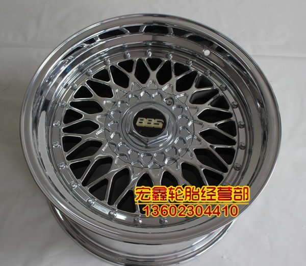

I have chosen BBS Chromes, but don't know what size wheels I need other than R18

As above you'll need 8j (8") front which is the width and 9j (9") for the rear those size wheels with the tyres you have will give you the correct radius. Stud pattern is 5x120 and the offset wants to be about et45 depends what's available in that wheel. If you ring the company your buying from they'll say wether they'll fit or not.

Yes, thanks. Daz also gave me some good info. So in conclusion, when choosing a wheel,I should take into account the following measurements:
1. Diameter (18' in my case)
2. Width: Choices eg. 8" front 9" rear or 8.5" all round (for my tyre sizes)
3. Stud Pattern 5 x 120
4. Off Set of et45 (which I think is the distance between the hub and part of the wheel closest to it).
Kindly let me know if I have missed anything

Fronts are 8J and rears are 9J, both with an offset of 35. The fronts sit perfect and the rears have 5mm spacers but sit pretty good even without them. Tyres are 225/40/18 on the front and 255/35/18 on the rear.
I would go for 8J upfront and 9J rear so they are staggered and get an offset as close to 35 as possible. If you go higher on the offset it wouldn't be a problem but it would look better with spacers to push them out a little.
