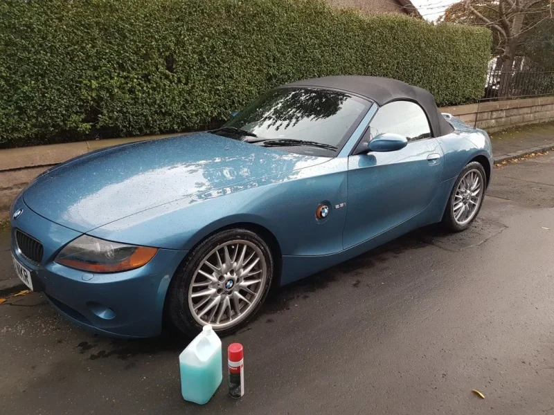

Hello and welcome. I’m a keen amature (but quite successful) detailer and it’s my write up HT shared for me. There are quite a few like me on this forum that’ll be only too happy to help. Where you based?
Hi Tony . Man blue 2.5 2003. Srry too busy driving it. I've been down to the shop 3 times for milk. Actually I think we're short of hair clips. ... and probably tomatoes.
Great looking car Conrad, I imagine there will be many runs to the shop before the fun starts to wear thin, then the local shop won't have what you need, Oh Bugger, you'll have to go further afield:thumbsup:=)) Enjoy.:)
Looking good, especially the wheels, MV1’s, but I am byest.
