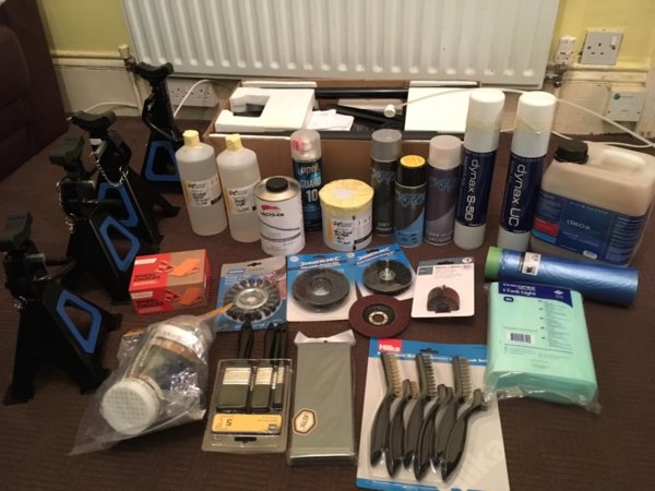

I was mildly horrified by the amount of stuff I had to acquire just to treat the two sills. I ordered all of this lot last week:
We have 4x 2 tonne axle stands; 3 tonne trolley jack; chocks; epoxy primer + activator + thinner; panel wipe; stonechip paint; primer, topaz blue base coat and lacquer aerosols; Bilt Hamber Deox gel, S50 and UC waxes and injection lances; various flap wheels and discs; brushes; tack cloths; masking film; and AP1-P2 mask (safety first!)
Not pictured is a cheapo Dremel clone and 60 mini wire cup brushes that arrived from Amazon after all this lot
