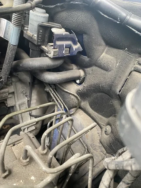

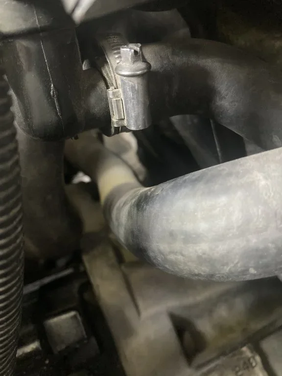

Done a bit more investigation around the solenoid heater control unit/valve. Heating was on max heat, engine and normal (middle) temp on gauge (no a/c). Air blowing cool. Checked pipes going into solenoid valve:
1. Pipe that feeds into solenoid valve - lukewarm at best
2. Pipe that comes out of solenoid valve into bulkhead - not warm
3. Pipe that comes out of bulkhead - hot
I've have not done any electrical testing on the valve connector itself.
Any ideas about what I could look at/check next?
Many thanks!

There are 2 hoses coming from the engine to the heater core, one stops at the control valve and controls the flow of water to the core.
There are 2 things that affect heat, a bad control valve or air in the lines. I have had both.
After replacing the control valve I had to run the engine for quite a while to get the air out, that was last year. This year I have not tested the system yet so have no clue if it will work for me.
There are bleeding procedures in the various manuals and website articles, I would suggest starting there.

During similar problems a few years ago I temporarily by-passed the heater control valve to eliminate it from problem. You can simply i) disconnect control valve inlet hose ii) short outlet hose to bulkhead iii) connect inlet hose direct to bulkhead connection. Run engine if heater then gets hot matrix is not the problem.
I've done that during the summer (I live in Arizona) to increase the cold air output from the AC and to bypass a defective heater control valve.
However, this led to more air in the system that needed to be bled out when I replaced the valve. Honestly, this is another poor system to troubleshoot that our cars have. It's difficult to know if the valve works or not at times.

One think that has me baffled though is why the "outlet" pipe from the bulkhead (matrix) is hot but the "inlet" pipe from solenoid to bulkhead (matrix) is cool :confused:

Heat transfer from engine through coolant it's only a short length - no flow through heater matrix hence cool.
