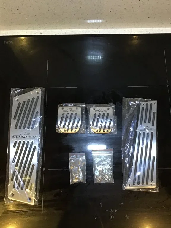

I keep forgetting to take my pressed metal plates off the car for mot haha, always fails for it every year. Also needed a new copper washer on a rear caliper as it had the tiniest leak.
